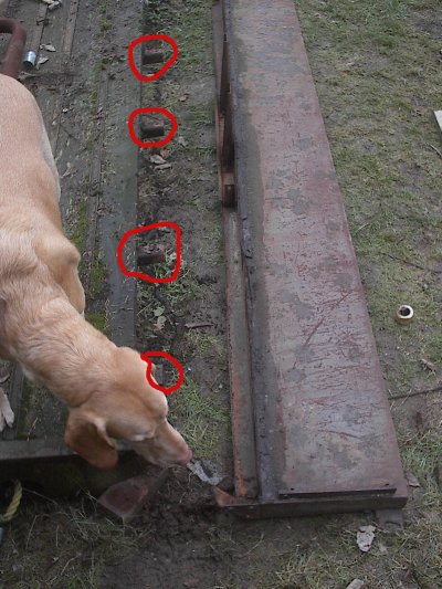

Basically there are 9/16ths and 1/2in bolts attaching the side to teh support beams that run across the bed. Take them out. There are also some flanges that are attached to the side and go further under the bed, about mid way. They have two bolts. Its all pretty straightforward.
After the snow and mud clear up I'll take off the front panel and the wood.
Here is the side off.  Notice the attach points sticking out from under the bed.  There is also an L channel that (in my case is rusted away) that support the outermost board.
