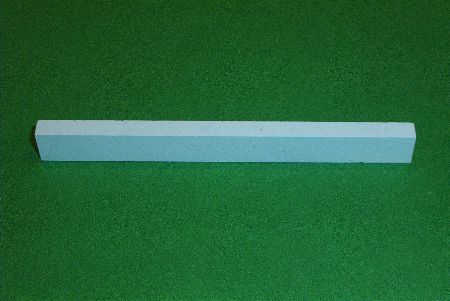

Commutator stones aka brush seating stones or brush cleaners.
There are several products that go by this name, you don't want the one with the two separate stones on a plastic holder, you want the one that looks like a square bar about 6 inches long.
The above stone is 1/2 x 1/4 x 4 3/4
I could not find a video to show it, but the cleaning operation is simple. Just remove the brush cover and while the commutator is spinning, touch the stone to the commutator with a light pressure. You will immediately see the copper get nice and bright. On a starter you are working around parts that do have several hundred amps going through them (a starter will see just about full battery amperage).... so don't touch any wires. The stone is not conductive, but the dust could be. It only take a second. A genney has 40amps at full charge rate... plenty of amperage to make your day suck.
One more note on commutators: ONLY GENERATORS HAVE THE MICA UNDERCUT! If your starter commutator has undercut mica that can be a problem.
Beware if you buy the stones online. I was able to get a local electronics store (Moyers) to order me a box a 6 for $30. Some places charge $30 for just two so SHOP AROUND.
