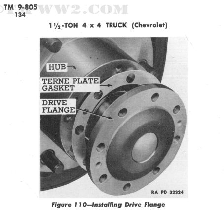

Since its PAINFULLY OBVIOUS that Gopan/Dover doesn't own any TMs, here is a quite common TM showing the magical friction terne plated gasket:
Its from an UBER RARE manual I bought off the Internet for $15 :roll: :roll:
Note how the bolt holes in the gasket are LARGER than the bolt holes in the axle flange.... because sloppy tolerances promote better friction hahahahahahahahaha
