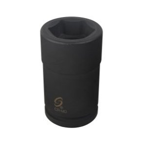

Since I have 3 truck, 9 axles, and boat load of tires to deal with finding the easiest way to deal with lugs has become a higher priority than I ever thought it would be.
The three options are:
Budd wrench: Nostalgic, but slow and doesn't handle rusted/painted threads very well.
Impact sockets: fast, easy, but having both a 13/16th and 1 1/2 impact socket can run $50+
SINGLE socket: Sunex 4826C 3/4" Drive Budd Wheel Impact Socket 1-1/2" X 13/16" for $22 delivered!
http://www.amazon.com/Sunex-4826C-Drive ... inch+drive
Its a single impact socket with both nut sizes in one. The outer nut socket for the 1 1/2 inch is not 'full length' so it will not engage the inner nuts 13/16ths head.
BRILLIANT!
