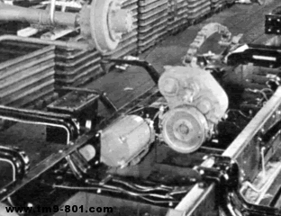

First, a big hug for my best buddy David Doyle. Page 177 of The GMC CCKW Truck in U.S. Service shows what can only be called CCKW cannon. A dated, sourced original production photo of the decal on a CCKW. This one photo is the most significant photo in the entire book. But if you read the authors caption its never mentioned.... that's ok.. one mans boring factory photo is another mans holy grail of CCKW proof.
Without further delay:
This puts the two vac decals on the BOTTOM of the vac toward the front (control valve end). If looking at the front (grill) of a CCKW the decals would be approximately the 5 o'clock position. This is different from other manuals. I have collected *lots* of CCKW vac decal photos from other trucks/vacs and there does not really seem to be a standard position. Most are at the 'front' of the vac, but it varies. I have photos of decals in the 9 o'clock and 11 o'clock position. So while the single factory photo we have shows it 'on the bottom' putting the decal's at the 3 or 9 o'clock position (so they are visible from above and protected) is a viable location.

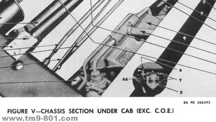

Compare this photo to the 1943 Bendix Form No 9-227 shows the decal here:
This is more like the 3 o'clock position. Oddly enough, this is at the 'rear' of the vac can. Most photos show when the decal is applied to dual piston vac, it's mainly on the front can (the one with the control valve mounted on it.
Here's a later Chevy vac (SNL-G-506 June 45) page 28 front of vac, right side (more of the 2-3 o'clock position)

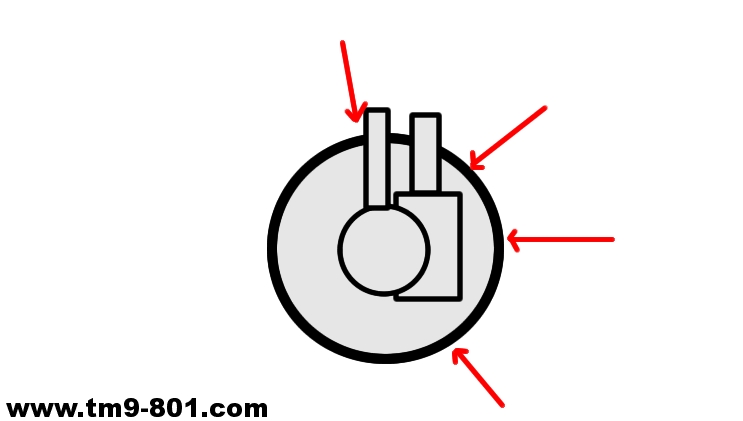

Here's quick graphic of where I can place the decals using only factory books or photos. As I mentioned above I do have several photos of take off parts that show the decals at 9 o'clock and even inverted.
