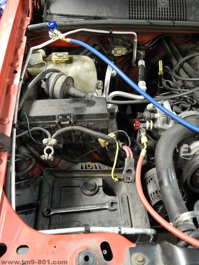

Here you can see the new lines... they are the clean parts.
I didn't take many pics, but this is one I took while I evacuated the system. Most web sites say to draw the vacuum for up to an hour(!). The ZJ service manual says 20 minutes. I did the 20 minutes.
