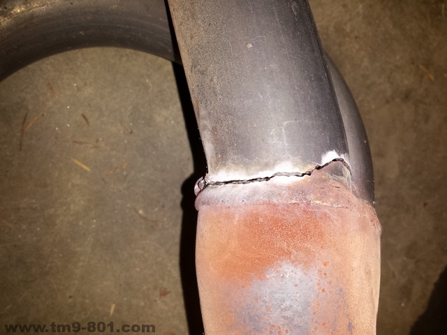

Well it seems that every once in a while the entire internet is right. The dreaded 'yo, your exhaust manifold WILL crack on your ZJ' prophecy has come true... I noticed that at idle and my windows down I was smelling exhaust fumes. I hoped it was just a lose exhaust flange... NOPE. Cracked manifold exactly where the crack was 'supposed' to be.

This is one of the common places the header cracks.. due to the long length of the tubes, when they heat up/cool down they move a lot and that leads to cracks.. this was repaired before (note the peanut butter aka blobs of weld).

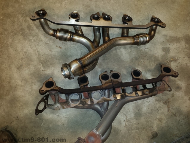

This is a side by side of the new/old parts. Notice the bellows on the longest tubes.. that allows them to heat up/cool down and not put any strain on the welds at the merge point.
