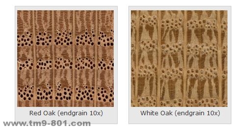

And lastly the king of 'I wish I knew it all' Bend-Me-Over-a-carpenter's-saw-horse regurgitates something about 'tell the difference between red/white oak.
CHALLENGE ACCEPTED!
If you look on youtube you will find videos of people blowing bubbles in water THROUGH red oak.
"As to the reasons why you’d want to be able to distinguish between the two, most of the answers have been explained above, but I’ll recap:
White oak is much more resistant to rot, and is suitable for water-holding applications, boatbuilding, outdoor furniture, etc.
Red oak should only be used for interior pieces such as cabinets, indoor furniture, etc.
White oak tends to be more dense, while red oak is a bit lighter and has a more porous and open grain.
White oak is usually slightly more expensive than red oak."
