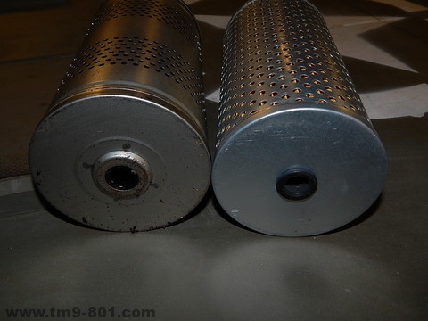

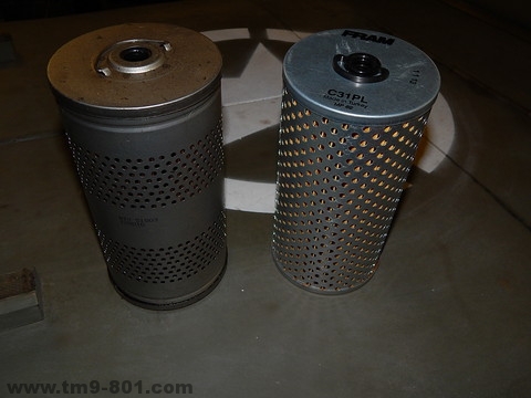

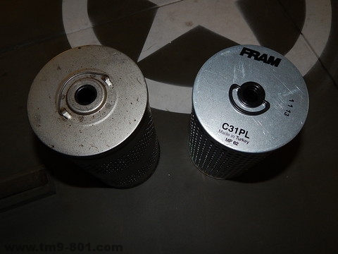

Got some photos of the C31PL next to a WIX 51503
As of 11/2015
WIX 51503 lists for $9.55 at Fleetfilter (shipping is $9)
FRAM C31PL lists $12.02 at Amazon
At a case (qty 12) the price difference is less than $2. But you will spend $130+ for them. If you want one-two the C31PL is a good buy. If you can do a case the WIX is a better deal.

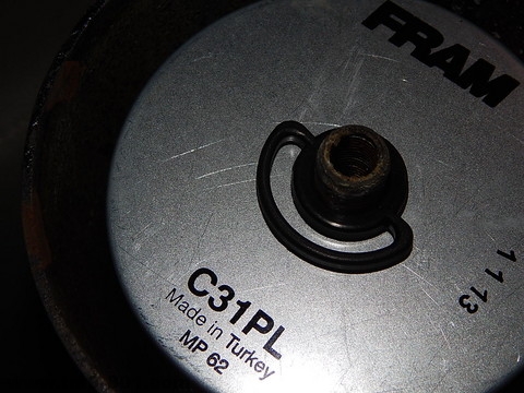

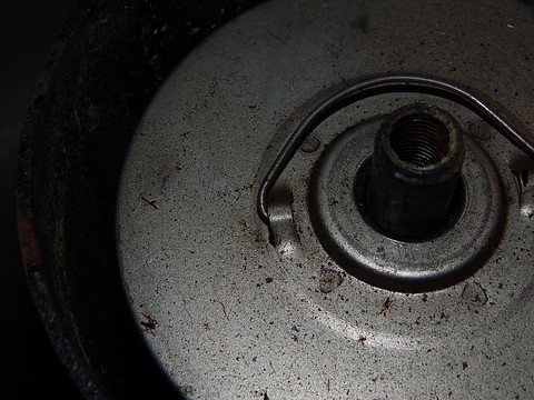

The Fram filter fits... my only concern is that WHEN DRY the silicon seals are very tight and the molded in 'handle' may rip if SIGNIFICANT force is needed to pull of off the center column. You can clearly see that the WIX filter has a stamped metal handle and the bottom seal is spot welded in place.. the Fram filter may pull the bottom seal out of the filter if it is very tight.
I am not going to get into filter media... as I'm sure both will filter fine.

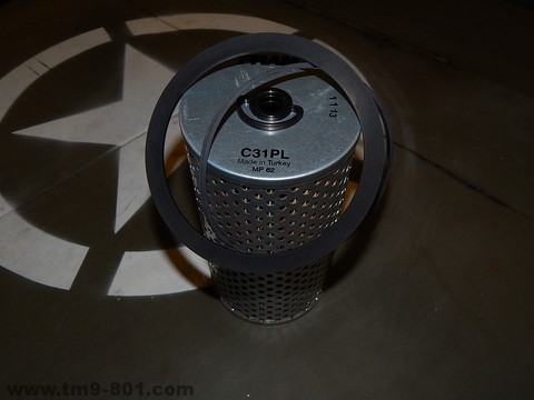

The FRAM does come with a lid seal and it does fit the filter housing lid.
I would use them both... but the silicon seals and how they are attached to the filter worry me. It obvious that the WIX filter is constructed much better.
