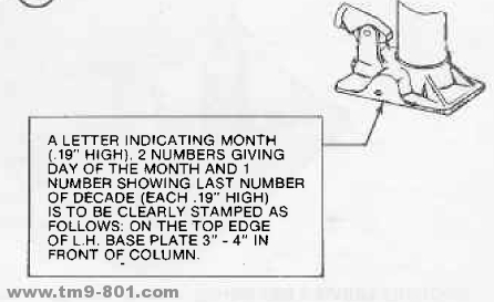

Found this online:

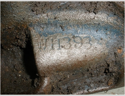

One of my jacks has 'WH393' stamped in the right location
W - Walker?
H - 8 - August
39 - 39th day of the month?
3 - Year?? 1933? 1943? 1953?
OR maybe it is WI1393
W - Walker
I - 9 - September
13 - 13th
9 - 1939? 1949?
3 - C (plate says its a 925C so 1-A 2-B 3-C 4-D for model number??)
