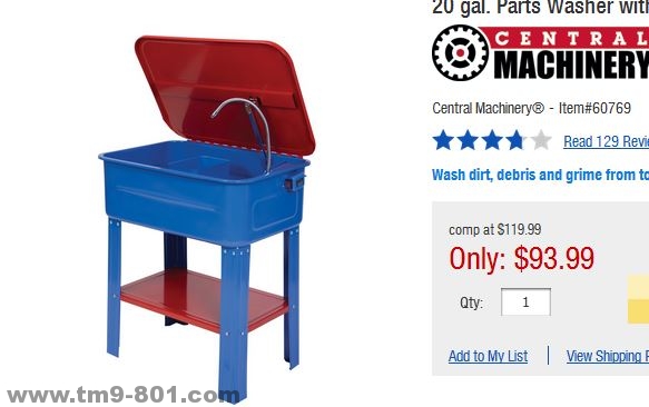

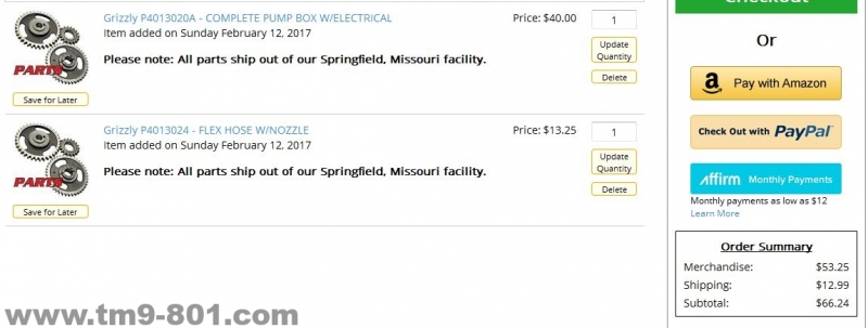

So I have one of the old blue and red HF parts washer. Its a good deal but like many I burnt out the pump using solvents to clean rather than water based. Since 2017 is "Year of the G506" cause shits been in my garage for way to long I decided to fix it. It needs a new pump. Well, I actually threw the pump away (I think) so I need the whole assembly.. housing, hose, pump, switch etc. So I find out that Grizzly sells the parts and are much closer than HF's CA parts dept. So I add up the parts:
Well fuck me.. an entire new unit from HF ($93 less 20% + tax) $79.70
And in both cases the pump STILL isn't solvent cleaner capable:
