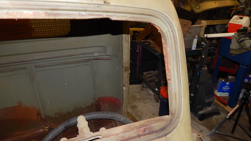

So the cab is off the frame and was pretty bare. I had already taken the doors off to weld up.
Taking the windshield and inside panel was the first job as I have to get to bare metal to sand blast and weld up some holes.

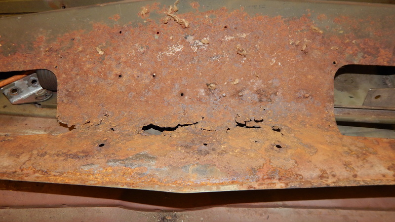

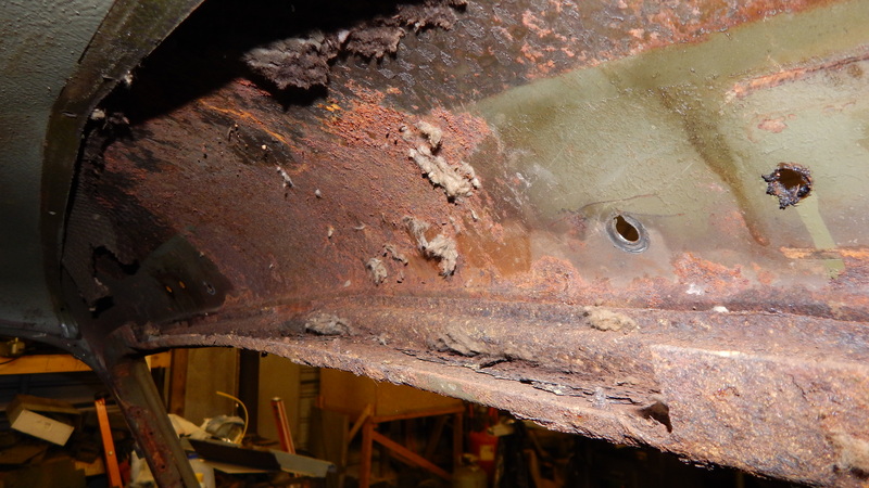

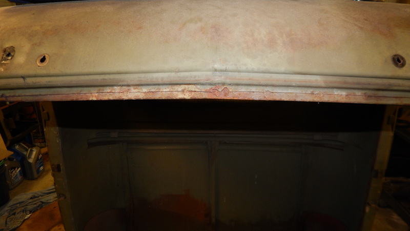

The first major 'what was the previous owner thinking??' discovery was they jammed a ton of jute into the header to insulate the cab (I assume). Well, that's nice. But they clogged up the normal draining of water and wet jute will cause all sorts of rust.
So far the damage is limited to the front panel. I have another truck to get a part off of, but take off the wiper motor access covers and look for rust.
Inside of front of the cab above the window where the jute was. The support beam is rusted, the wiper motors were corroded, the vacuum lines to the wipers were gone.

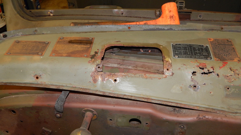

The top panel. All that wet jute ate up the metal. Its gotta be replaced. Luckily the data plates are not damaged.
Luckily the access panels to the wiper motors were good, as were the wiper windshield hinge backing plates.

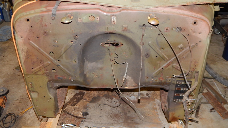

The cab frame and most of the front cab sheet metal is in good shape.
