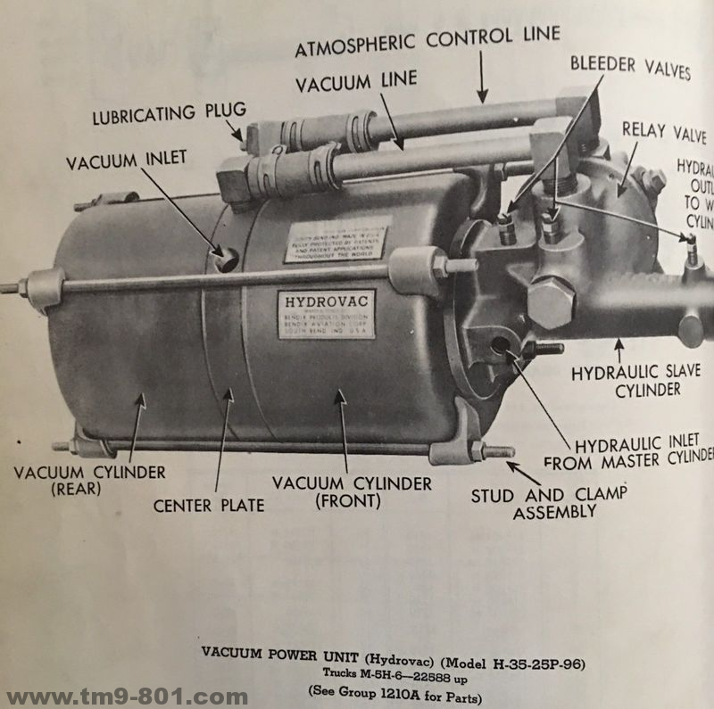

Source: ORD-9 SNL-G-561 Issued January 28, 1945 for the International 2 1/2 Ton 6 x 6 Truck Model M-5H-6
MONEY SHOT!
No CCKW TM shows decals, so I found this part book with a photo of the exact same 'vac. Sometimes you just get lucky.
