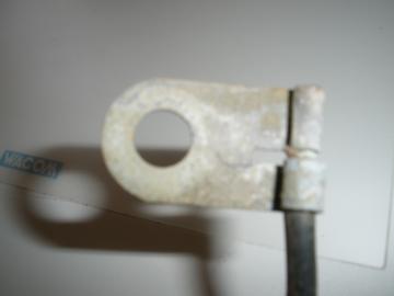

Here are some pics of the flat terminal, loop type off my obviously post war french harness.
You need a special roll crimper die to get a nice tight crimp. The second photo seems to be a generic guage terminal... its on an 16 gauge wire, but it looks like it could fit over a much larger wire.

Not factory correct as seen on the G506/G508. They could have been supply issue, but not from GMC/Chevvy.
Here's what I see from my factory orifinals:
I believe the originals are tin plated brass. I have not seen any pure brass connectors.
Both legs are 'thick'. Factory parts have 1 thin 'leg' for the actual inner wire to be soldered to, and a 'fat' leg to hold the wire where the insulation is not cut.

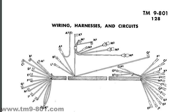

Here's a drawing that even shows the legs on all the flag connectors being different sizes (TM9-801 pg 257)
Some Original flag terminals that show the leg sizes and general construction.
