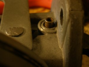

Here are the pics of the final part of the rebuild. Using a deep well 3/16th socket to support the head, I used a center punch to spread the hollow end of the pin over a captive link. A few taps with a hammer and she's all rebuilt!!
Here's the pin that connect the link to the arm and also allows the primer lever to actuate the link no matter if the arm is actuated by the cam lobe or
not.

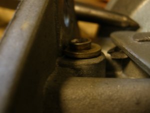

Here's the 3/16th deep well socket used as a bucking bar to keep it seated while I tapped on the center punch to expand the other end

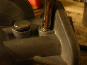

Here's the result. Since this is not an official CCKW fuel pump rebuild kit the metal keeper is not a 'stock' part. But its a more elegant solution than smashing the pin into a formed head to keep the pin in place. I'll live with the ridicule of not having a 100% CCKW fuel pump. :lol:

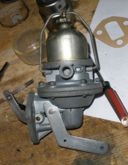

Here's the rebuilt pump. Installing the internals is not difficult.
The pump was bead blasted with glass beads and a Harbor Freight hand held siphon blaster, then assembled. The new fuel bowl and bale were e-bay finds. The gentleman I got the pump from sent both a glass and metal bowl, the metal bowl is not in good condition and the glass bowl is wrong.
