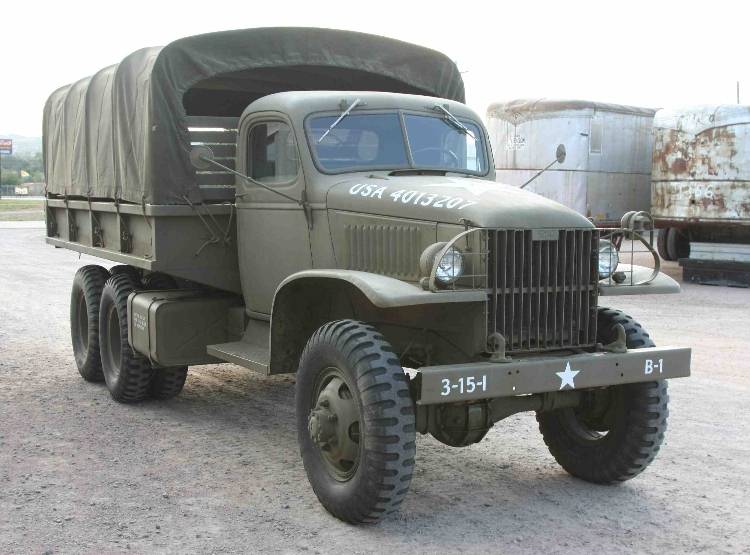

Good
Second model closed cab, correct grill with GMC logo. Retrofit BO light. Proper running boards with no gas can mounts or pioneer tool brackets.
Not sure:
No splash guards?
No fuel tank filler?
Stencil on fuel tank?
Bad:
Wrong bed!
Passenger side mirror (not stock)
Wiper arms appear unpainted
No National Insignia on door (AR850-5 1942 pg 14)
WWII TRUCK

Good
Not sure:
No splash guards?
Bad:
Wrong bed!
Not Good
Got 1st series cab
Wrong grill for second model its too long on driver side, retro BO lite Bkt is wrong for that grill
Got 900-20s
Got open cab mirror bkts
Got M series gas tank
Got no rear window guard
Got Bogus USA#
Got wrong gas tank bkts

Good
Not sure:
No splash guards?
Bad:
Wrong bed!
Got wrong lugnuts

incorrect wiper arms and blades

I thought the 'first series' cabs had the mirror brackets on the doors, then the second series closed cabs moved them to the cowl.
Missed the GMC logo on an asymmetrical brush guard.. I was dazzeled by the early BO light.
Can't tell about the mesh rear window protector... pics is not clear enough.

CCKWX thru CCKW SN 41189 had 1574 Cab with mirror bracket on upper door hinge.
Also had leaded in seam at junction of cab top and cowl.
Rear window mesh guard is missing.
