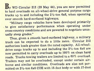

Also, if you need a TM, here it is:
WDC 212 29 MAy 44 allows for the 100% overloading of GMC 6x6 trucks.
Black letter law.
Re: A CCKW can hold 10,000... you knew that, right?
Here's the snippet from the Army Motors (Aug 44 IIRC)
