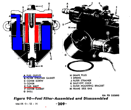

Every CCKW TM has this wrong.
Ever notice that the fuel filter diagram in all the TMs for the CCKW is wrong?
Pretty straight forward... this is from the 1944 TM9-801. Your filter is gonna clog pretty quick, plus water will get through.

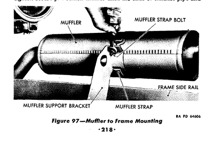

Here's another one that may appear wrong, but is actually correct.
You are looking DOWN on the muffler as if the cab was removed. The tip? The anchor point on the parking brake is on the left side. Its an odd perspective, I though it was upside down.
