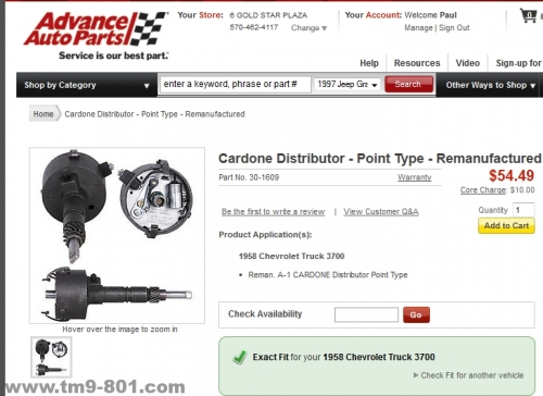

Ordered a rebuilt dizzy from Advance Auto.. $56 with a $10 core... the whole dizzy/rotor/cap/sparkplugs/shipping came to just under $97 That's with 15% off and $25 credit for next purchase.
http://shop.advanceautoparts.com/webapp ... nt=general
Vendors wanted $130 for a rebuilt dizzy. Silly vendors.

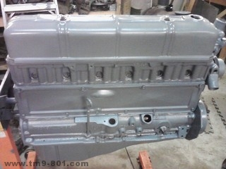

Lots of little things done. Here is the motor all painted up:

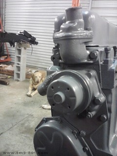

Here's the 'high mount' water pump and adapter plate:

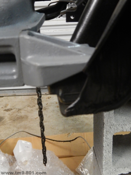

I had to lower it back onto the wooden dolly to mount the flywheel, clutch and bell housing (not in that order). Its good to have a garage big enough to have a gantry crane:

Rebuilt dist really pissed me off. The notch to index the rotor was not parallel and had to file it true to get the cap to fit. Cardon rebuilt parts are not going to be on my 'buy again' list. I do have the original dist.. .but without a rebuild kit I didn't want to use it. It seems OK (no play on shaft) but for $60 it was cheaper to get a new one that rebuild... but the rebuilt has its own small issues :(

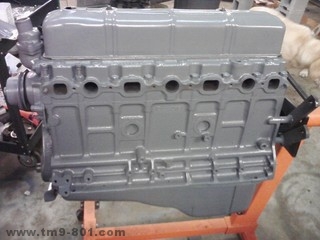

What's up with that angled exhaust manifold? It must have been mounted on your late model engine... Tried to "quote" your post and the original pic, but failed. Perhaps because it was an attachment?
Re: Motor.. final anwser
The exhaust is from a 58 235. The exhaust manifold 'bent' in the 50's. I have a numbers correct exhaust manifold for a G506 235 and its 'straight'. But both post war 235s (I have a 52 and this is a 58) are 'bent'.
The intake ports on the later 235 (the magical 848 heads) are larger and the early 235 manifold from the 40's will not fit. I tried it.. its doesn't work. Also the manifold studs/bolts are slightly different as are the clamps.
