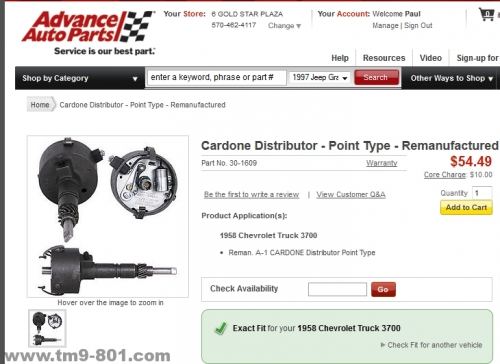

Ordered a rebuilt dizzy from Advance Auto.. $56 with a $10 core... the whole dizzy/rotor/cap/sparkplugs/shipping came to just under $97 That's with 15% off and $25 credit for next purchase.
http://shop.advanceautoparts.com/webapp ... nt=general
Vendors wanted $130 for a rebuilt dizzy. Silly vendors.
I'm going to start WITHOUT a dizzy vacuum advance to keep things simple.. but will be adding one. Here the vendors beat Advance Auto by like $20 for the vacuum advance... plus the vendors have the vacuum line. Should be about $60 to add... but the gas it saves me will more than make up for it.

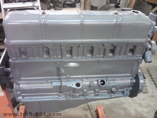

Lots of little things done. Here is the motor all painted up:

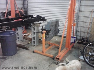

I had to lower it back onto the wooden dolly to mount the flywheel, clutch and bell housing (not in that order). Its good to have a garage big enough to have a gantry crane:
I also painted a ton of stuff.. balancer, dizzy, lots of door parts. The rear motor mount bolts are going to be a PITA to find (9/16-16 x 1 3/4th) the two local hardware stores didn't have them... might have to Grainger them or try the local nuts and bolts place... but they have a $5 min.

Rebuilt dist really pissed me off. The notch to index the rotor was not parallel and had to file it true to get the cap to fit. Cardon rebuilt parts are not going to be on my 'buy again' list. I do have the original dist.. .but without a rebuild kit I didn't want to use it. It seems OK (no play on shaft) but for $60 it was cheaper to get a new one that rebuild... but the rebuilt has its own small issues :(

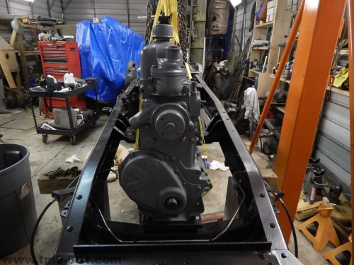

Posted: Thu Oct 31, 2013 7:43 pm

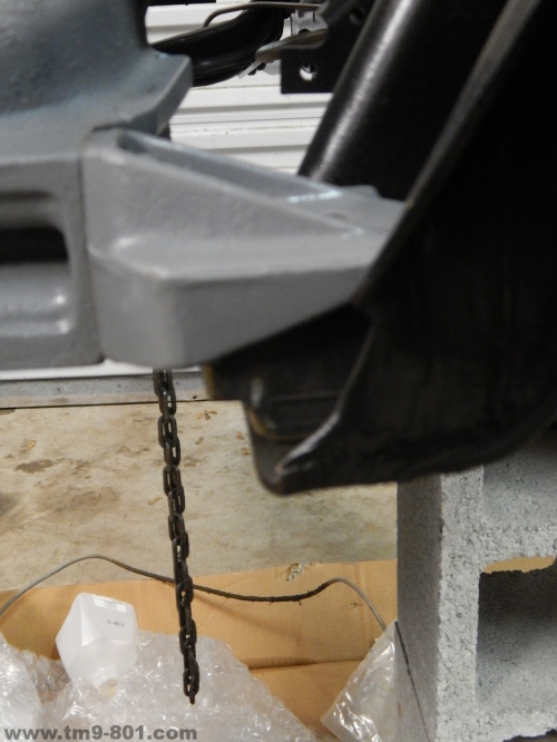

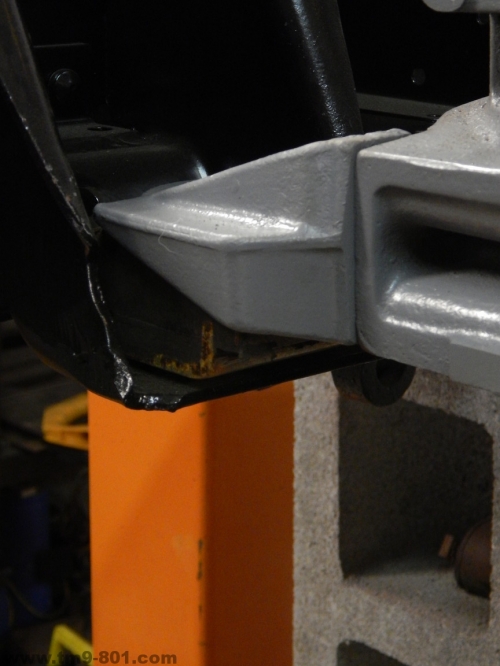

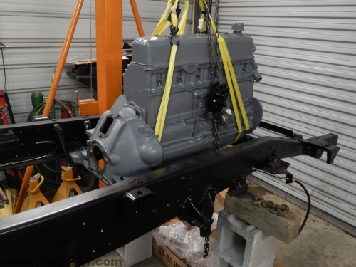

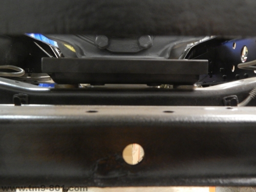

The motor gods have smiled upon me!
Sitting in the frame:
Still need to drill bolt holes for the front mount:
My other truck still has the original shield... and its very rounded, the square shield they are repoping is a very shitty (aka CHEAP) substitute.
Rear motor mounts:
Once I get the front mount drilled I'll finish the brake and fuel lines. I also have the splash shields (a full set! Whoo hoo!) to install. I'm only about 3 months behind where I wanted to be... I still have to break in the motor... but I want it on wheels before I try that (so I can roll it outside and start it).

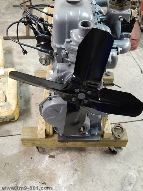

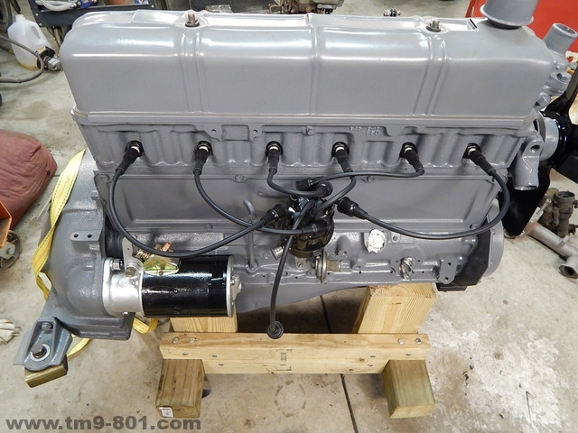

Update on the motor:
Fan installed, dist in and timing set, plug wires installed, starter on, carb linkage checked. Kinda looks like a motor now. Need a genny...

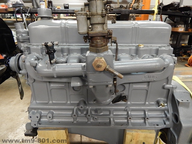

Re: Motor.. final anwser
Posted: Thu May 08, 2014 10:35 pm
What's up with that angled exhaust manifold? It must have been mounted on your late model engine... Tried to "quote" your post and the original pic, but failed. Perhaps because it was an attachment?
Posted: Wed May 28, 2014 12:22 pm
The exhaust is from a 58 235. The exhaust manifold 'bent' in the 50's. I have a numbers correct exhaust manifold for a G506 235 and its 'straight'. But both post war 235s (I have a 52 and this is a 58) are 'bent'.
The intake ports on the later 235 (the magical 848 heads) are larger and the early 235 manifold from the 40's will not fit. I tried it.. its doesn't work. Also the manifold studs/bolts are slightly different as are the clamps.
