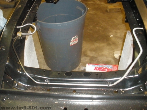

I would LOVE to only need to 'tweak' a line! But for $300 they simply didn't fit. Look at that photo of the master cylinder to vac line and tell me where its supposed to be routed... sure as heck not under the transfer case cross member.

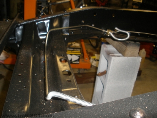

Here's the properly bent tube next to the old one
NEWOLD
Re: VoV brake line kit
Wow!
FINALLY!
There was a bit of discussion on weather the J-type clip or the 'duck head' type clip was proper... my 41 chassis had the duck head clips, the other two had the j-type clips.
I'm happy with it.. lets hope that the Classic Tube pattern is changed to reflect the proper lines.
If you look at the line going to the front right wheel (it looks like a question mark at the fitting) that's the one from the VoV kit.. notice how the loop is not continuous... it flattens out from 3 to 1 o'clock... this is the line that was included in the VoV kit. The originals really do look like a question mark.
