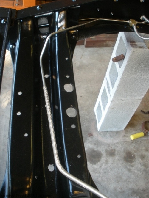

Here's the properly bent tube next to the old one
NEWOLD

Posted: Mon Sep 16, 2013 9:42 pm
FINALLY!
There was a bit of discussion on weather the J-type clip or the 'duck head' type clip was proper... my 41 chassis had the duck head clips, the other two had the j-type clips.
I'm happy with it.. lets hope that the Classic Tube pattern is changed to reflect the proper lines.
If you look at the line going to the front right wheel (it looks like a question mark at the fitting) that's the one from the VoV kit.. notice how the loop is not continuous... it flattens out from 3 to 1 o'clock... this is the line that was included in the VoV kit. The originals really do look like a question mark.
