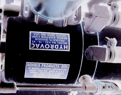

Came across this photo:
Should be enough to figure out the top decal. It's obviously much different from the M-8 decal that has the model number of the vac on it.

I have gotten the text of the decal BK-10823
There appears to be at least two separate versions that have the same text, but different fonts. The complete text is:
Yellow and black print
1 BENDIX PRODUCTS DIV.
2 OF BENDIX AVIATION CORPORATION
3 SOUTH BEND IND MADE IN U S A
4 WHOLLY PROTECTED BY PATENTS
5 AND PATENT PUBLICATIONS
6 THROUGHOUT THE WORLD
The decal 372001 appears to have the same information. The only line I can't seem to get any idea of what it says is the second line, under the big 'HYDROVAC'
1 HYDROVAC
2 ????????????????
3 (?) BENDIX PRODUCTS DIVISION
4 (?) BENDIX AVIATION CORP
5 SOUTH BEND IND U S A

I *THINK* I have the decal 372001 figured out.
1 HYDROVAC
2 MANUFACTURED BY
3 BENDIX PRODUCTS DIVISION
4 BENDIX AVIATION CORP
I scanned in a 9600dpi (681 mb for just a 2x3in section! Thank god my laptop ROCKS) and loaded into fireworks. I inverted the colors and then started playing with the contrast and brightness till I got the best image I could. Its two words, "Manufactured by"
I originally thought it might say Model Number but there are three things that changed my mind:
The TMs never say refer to it by any other method than the tags
The part number for the decal is the same over 4 different models, both Series I and Series II
The pattern of the 'splotches' didn't lend themselves to the pattern of a model number.
I have emailed a few people and hope to hear back, or even (with much luck) get a photo.
But right now I think I have the text, and can determine the rough size from the images.
Here's the reverse I used to the the first decal... some may say that the second from the bottom line is incorrect.. but it clearly says 'Publications'.
