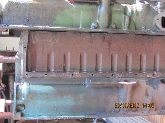

Just reposting this photo. Note the change in color from the engine to the transmission.

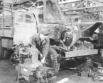

And another engine view from Fort Knox - very early truck possibly a 1940 model:
http://www.loc.gov/pictures/item/oem200 ... /resource/
Re: ENGINE PAINT... SOLVED!!!
This might be Studebaker or some other 1.5/2.5 ton truck. The air cleaner and location of the voltage regulator don't look appropiate for a G506/G507.
But it is very interesting that the air cleaner decal is what we think it should be, square AC, not rounded or curved.
The blue denim work uniform puts this as 40-41 but the photo info says Created/published in June 1942. It could be that Negro units were still issued work denims as they would have not gotten newer clothing when it first came out that's why they are still in denims so late.

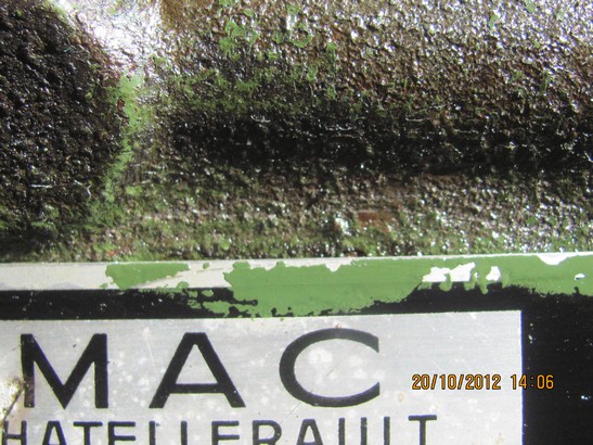

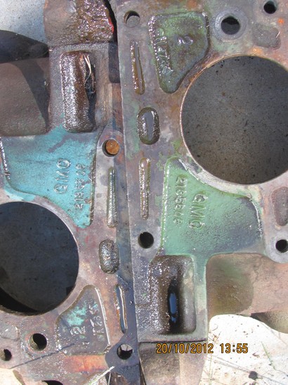

I too thought that the correct color is the medium green (close to British Racing Green or a wet olive) until I started disassembling the engines in my two current trucks.
The first truck, produced 11/43; engine serial #270442893, went to Europe and was turned over to the French. Engine was rebuilt by them in 1961. This engine is the medium green as indicated. It has a French rebuild tag and some of the green is on top of the rebuild tag (see pic) showing that this color was definitely applied by the French. Did they use the same standard GMC paint? Bell housing is also this color. The second truck, produced 1/44; engine serial #27072594I, did not go to Europe as far as I can tell. The engine in this truck is a blue/green turquoise. This color is listed as a standard GM engine paint color starting in the late 30's and through part of the 40's. This listing is unfortunately for civilian vehicles. The color is listed as GM Alpine Green (I have also seen it listed as Detroit Diesel Alpine Green). Dupli-Color makes this paint and it is their part number DR1618. Note: I have not purchased any of this green to color match against the original paint. This color was also on the bell housing. Neither engine have any color under the colors shown. If these are not original colors they the complete engine from bell housing to oil pan to valvel cover was stripped of all paint. Any thoughts?

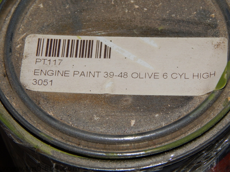

That's the exact same paint I bought.. read about it here:
https://www.tm9-801.com/forums/viewtopi ... ason#p1069
Its good stuff. Many reliable sources have reiterated that this IS the factory 'olive' paint used by GM.
Its expensive, and kinda difficult to shoot (a little thin, use light coats).

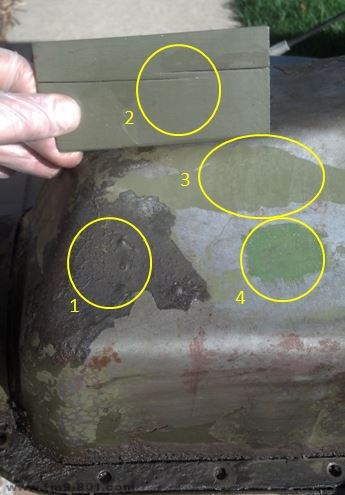

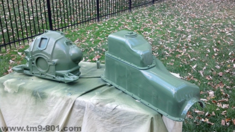

Anyway, I brushed on a quick test patch, and the color seemed to be pretty close. I am basing this off of the oil pan on my project engine. According to the tag, it's last government stop was at the Rossford Ordnance Depot. I am assuming that it was here that it received a heavy (very heavy) coat of dark OD green. After chiseling that off, I found a few remaining patches of what I think is the original GMC paint. At least it matches the my new paint.
The attached pic (below) shows the colors:
1 = Dark green - presumably R.O.D.
2 = GCI "319" reference - from one of the jeep places
3 = Original GMC ?
4 = Classic Parts / Jim Carter "Mystery Paint"
[attachment=1]Oil Pan 1.JPG[/attachment]
So. Throwing caution to the wind, I donned my respirator, poured the contents from the unmarked silver can into my gun and went to work. I'm not a painting expert, but I have shot a car or two in my time. The stuff smelled and behaved an awful lot like acrylic enamel - i.e. you have to put it on just thick enough to get it to dry glossy, but not a hair thicker or it will run faster than the babysitter's boyfriend when the car pulls up.
(They must also have thinned it with a low temp reducer, because it dried super fast, even though the outside temp was around 58 deg.)
The results were not too bad. However, I would have liked to add just a wee bit more reducer - if I knew what kind to add:
[attachment=0]Oil Pan and Bell Housing.jpg.jpg[/attachment]
So, to summarize, I give this project the following grades:
Customer support: F-
Coverage: C*
Color Match: A
Ease of Use: C
* I gave coverage a C, because when I buy a quart of paint (especially for $50), I expect to get one quart of actual paint - not paint that has already been "thinned" for me. (Kinda like when I buy Scotch - it doesn't already come with the "water" in it). Since the thinning ratio is usually around 5:1, I figure they owe me another 5-6 oz. of paint.
Anyway, I hope that this stuff is actually "engine" paint, and holds up OK. If its just plain ole acrylic enamel, I could have just taken my oil pan down to my local paint dealer and had them match it up for me, and saved a lot of aggravation.
If it starts to flake or burn off too easily, I am going to be really pissed.
Best Regards...

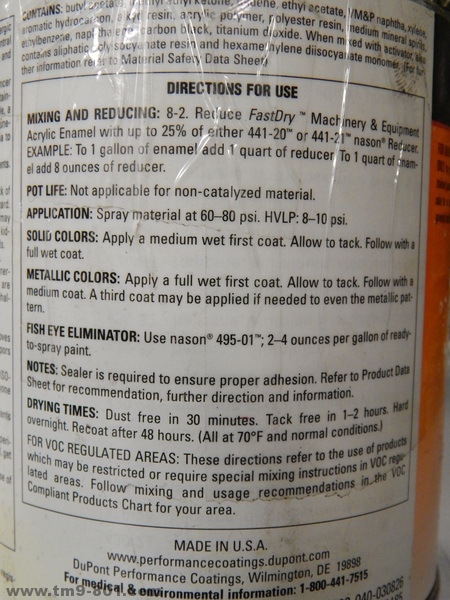

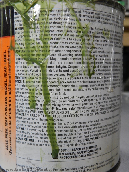

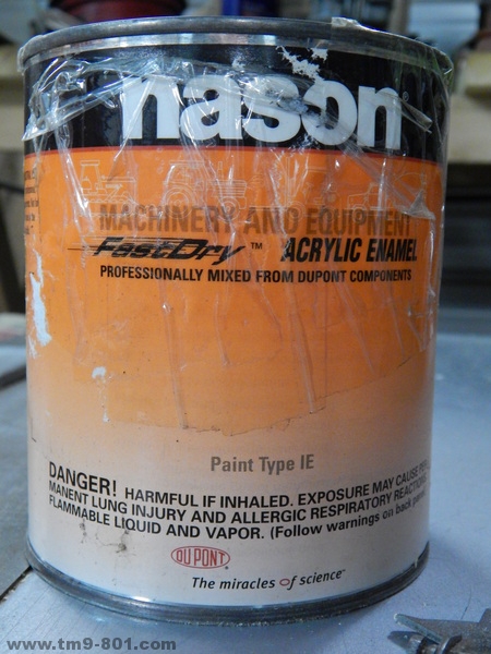

Here is the official (?) NASON/DuPont can:
Note the all important 'how to use' part.
