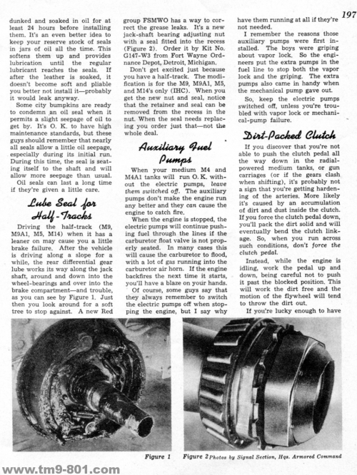

I'm going to have to officially say that you need the seal.. no matter what other trucks had/didn't have it.
Seems that the November 1943 issue of Army Motors proves my point:
Before anyone say's I'm hiding something the original page is included for download.. I just wanted the image to show the article and images.
I'm also not saying that the seal is the EXACT SAME PART as the ones used in the G506/G508 but it disproves the statements that NOT having a seal presents 'no real problem'. I'm sure on flat level ground its not an issue. But where i live flat level ground is hard to come by. If you live in the midwest or Florida this will not be an issue. But it was a big enough deal for IHC and the Army to put out a FSMWO to correct it.
