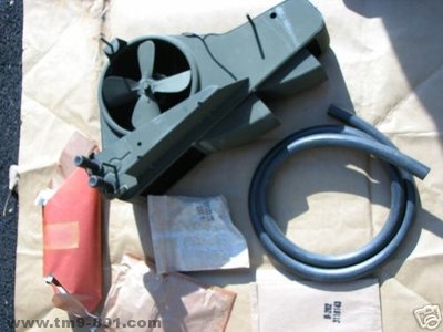

Why not just email Gopan/Dover whatever he calls himself now and get a photo of an NOS heater like he says he has? Of get a person he sold one to to snap a photo? Just show me the original box and heater and we're done.

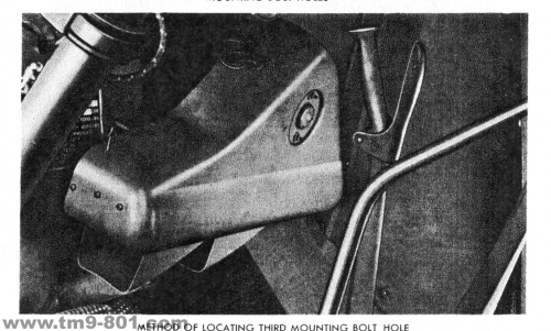

Someone posted this a while back... for sure they still have the heater
Re: Harrison Heater
Doesn't your heater look like that from the back? I have a used one, and it does. I have pictures (including the ones posted a few pages back) of a re-packed (presumed NOS??) heater (which you just re-posted above, emblazoned with the tm9-801 watermark), which is representative of the ones Joe Gopan is selling (or was anyway). I presume that it also is representative of the one he has in his truck. so there are at least three of them, and they also share the common feature of bosses on the front. I have never seen an actual cab heater without the boss. Like you, I have seen a heavily doctored photo illustration of one (or at least a photocopy of one). My point to all this is there are real examples of heaters with bosses that have been seen and are known to exist. The photo illustration would seem to indicate that they MIGHT have existed without a boss.

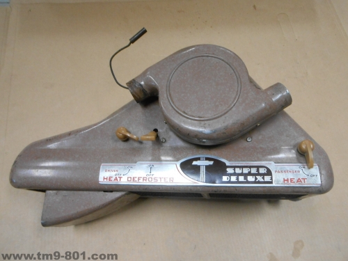

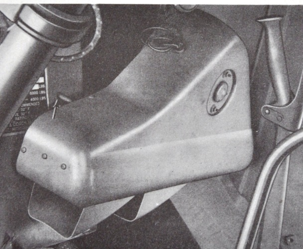

I can only hold up YT-4336 and the photo included:
No boss.
I really appreciate the effort and I also am collecting bits as I find them (such as the GMC heaters start with an I). I still stand by the photo and that the boss, the punch outs, and the other bits of the SUPER DELUX type heaters were not part of the Army unit.

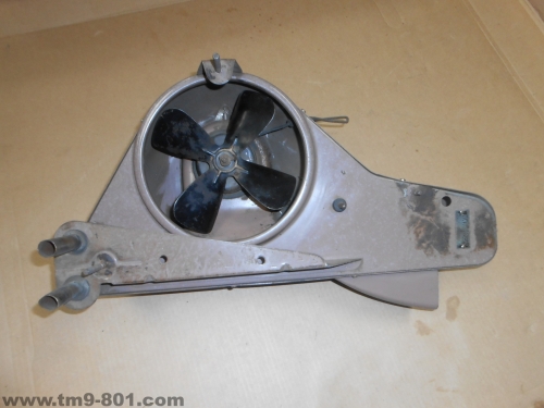

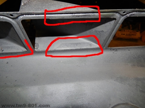

Take the shell. The Army unit has two ducts to direct air to the driver. They are centered over the bottom vents. That requires a flange on each vent to spot weld the ducts to:
The DELUXE heaters do not have this 'middle' flanges at it appears that the flange it does have is much longer:
This is a fundamental difference in the shell stampings.

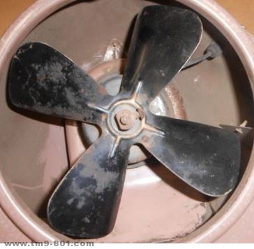

Also, the DELUXE HEATERS would require MORE holes punched around the motor to allow hot air to be pushed to the defrosters, and an additional internal duct:
Plus a motor with a through shaft so fans could be installed on BOTH ends.
That's a LOT more than just the boss.

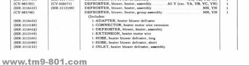

I maintain that the Army heater was an initial version of the DELUXE HEATER without the boss. The fact the the model 1574 and 1608 closed cabs never included ANY provision for defrosters leads credence to that. But the parts book DOES list the ash tray: TRAY, ash, instrument board, assembly
Whats odd is that the G506 EXPLICITLY LISTS a defroster:
But from the G506 TMs it is not the same triangular type as a CCKW heater. These are, for all intents and purposes, the exact same sheet metal, and the firewall is basically empty in the same locations.
