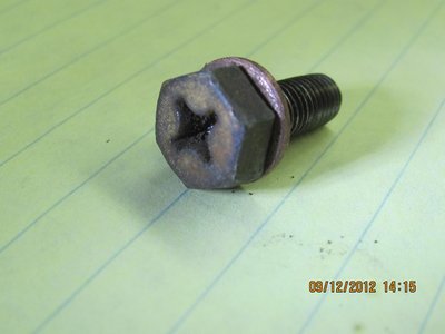

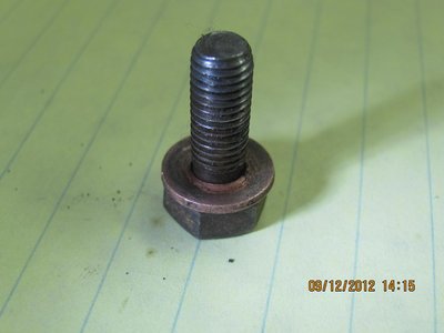

For those with the two piece oil pan there are two noticeable differences in the tappet cover/upper oil pan half and the lower oil pan sump screws. The lower sump screws are 1/4-28 (fine thread) vs the 1/4-20 (coarse thread) and they are 5/8" long vs 1/2" long. See picture of lower sump screw.
Lower oil sump screw 1
Lower oil sump screw 2

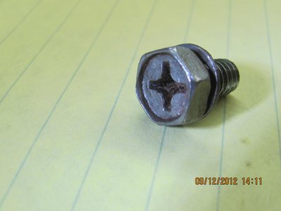

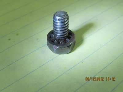

Finally I mentioned referencing the post war civilian engines. They use a screw that looks like the one referenced in your TM10-1562 Parts Manual (what year is this manual from?) and the 1945 SNL-G-508. Do either of these manuals have any pics? I do not have these so can not reference. See pic of post war GMC engine screw.
Post war GMC engine screw 1
Post ware GMC engine screw 2
Note that the civilian screw has the integral internal tooth washer as is described in TM10-1562 and SNL-G-508, while the flat faced screw from above does not. The question now is does anyone have any pictorial evidence of the recessed face hex head with phillips slot screw being used? Does anyone have any examples of the flat faced hex head phillips screws in 1/4-20 x 1/2"?
