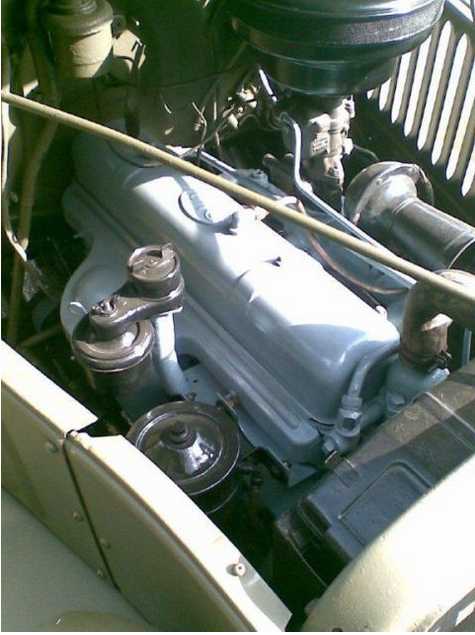

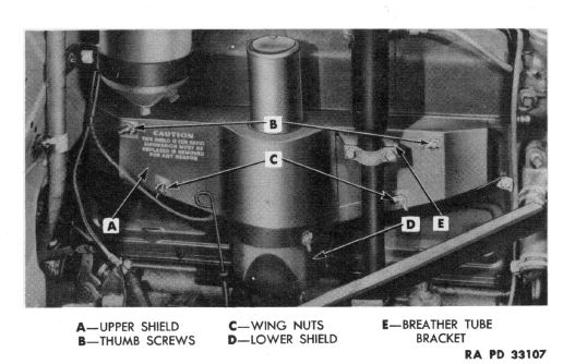

Here is the tin shield on the G506:

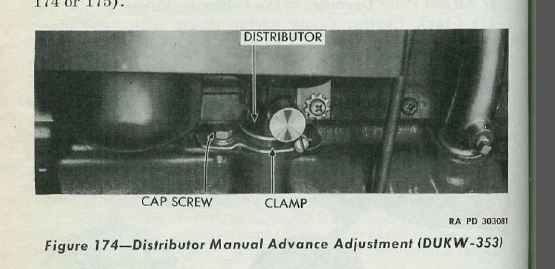

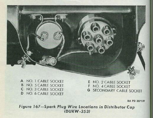

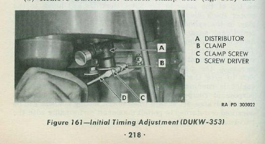

Here is it on the DUKW (well, best pic I have):

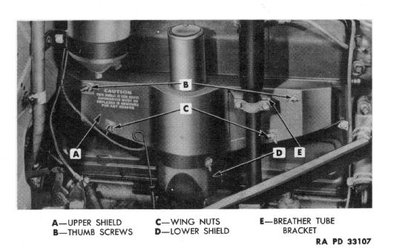

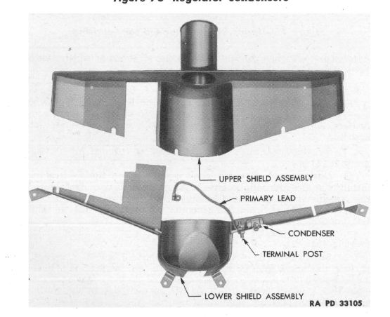

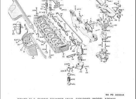

Here is the SNL photo of the CCKW/AFKWX shielding:
Supposed to be on CCKWs after chassis number 394577. That would be 1944-ish.
My copy of TM9-809 AFK WX-353 27 May 43 shows no such shielding.
I don't think I have ever seen a CCKW with the shielding, or a picture of one.

the bottom photos are like the one i have it is flimsy but i had never seen one so it was carefully removed .it was on a timken axle cckw.thanks for all the info and photos.

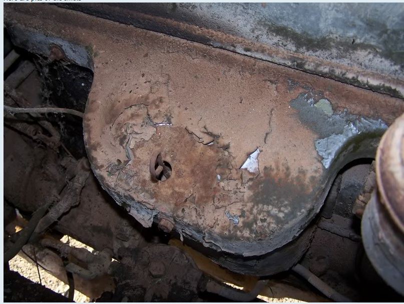

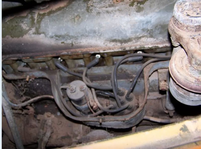

This photo is from a bolster truck listed for sale on ebay.uk
Other than being all kids of the wrong color its an excellent shot of the tin shielding used on DUKWs and some specific CCKW models.
