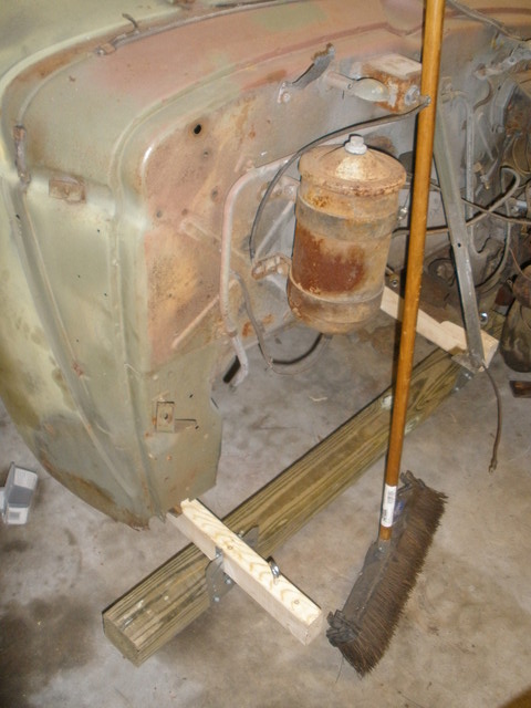

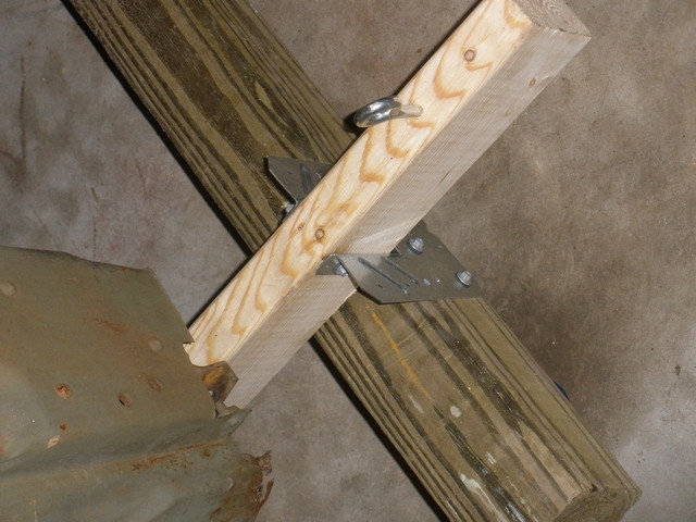

Lowes sells some metal brackets... I used them to make my ghetto cab dolly:

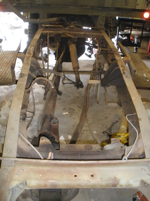

Just about everything forward of the transfer case is out. Bed comes off tomorrow then next week sand blast a thon!

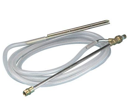

I've settled on pressure washer sand blasting the chassis (both of them). The costs involved with a professional sandblaster ($450 per frame, plus towing to/from @ $75 each frame each way = $300) was simply to high. Even though the guy had no work all week he wouldn't do it for less... now he gets nothing.
For $800 I could rent a 185CFM compressor and 2cu.ft media hopper but that would entail covering the entire neighborhood in sand. Not a realistic option.

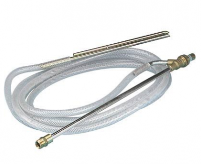

So I ordered the pressure washer attachment from Northern Tool:
For $60 and will be renting a professional sized (3000psi, 3.8GPM) washer for a week, total cost $375 for two frames.
