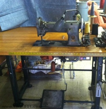

Got this off ebay for $250 (table, head, motor) and it works perfectly. Got a few projects done and this thing sews like a boss. Still trying to slow it down (I really don't need to sew 3000spm.. I'd be happy with 1000 :) )
Great deal. Guy was 93 and was finally selling off some machines so he could retire... AT 93!!!!
