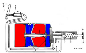

The vacuum would normally bleed off in a few hours anyways (via the intake check valve most likely).
Correct me if I am wrong, but pumping the brakes would admit atmospheric air to the 'back side' (RED) of the pistons and the vacuum side (BLUE) would not really 'release'.. just be compressed. So you would have a fully engaged piston and piston rod still having a vacuum on it the seal..
Now you would have vacuum on the seal PLUS the spring wanting to return the piston to mid point. As long as your intake check valve holds, you will have a vacuum on one side of the piston.
Re: Interesting Hydrovac observation...
Posted: Wed Jan 28, 2009 7:42 pm
by MotorpoolMac
There is a tube that connects both sides of the vacuum cylinder to the line to the manifold. Therefore vacuum is delivered directly to the Blue side (in your diagram) and through the control valve on the Red side.
Here is a link to an original Army training film explaining the operation of the hydrovac system:
http://www.youtube.com/watch?v=keChCevuKk8
When the engine is not running we have only a limited amount of vacuum. Pressing the pedal allows atmospheric pressure to reach the Red side as you described, but when the pedal is released the control valve shuts off atmospheric pressure and opens the Red side to the vacuum line again. This is in practice "connects" the Red side with the Blue side.
If the engine were running the vacuum would clear the Red side of pressure while keeping the Blue side clear, returning the system to equilibrium. However, if the engine is NOT running when the pedal is released, the control valve again “connects” the two sides and the atmospheric pressure on the Red side then "contaminates" the vacuum on the Blue side.
Pushing the pedal again allows more atmospheric pressure in to be let into the Blue side when the pedal is released until all the vacuum is gone.
