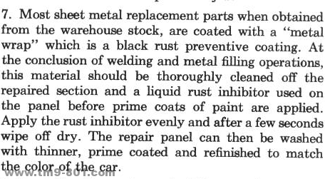

I found this blurb in the 1941-42 Fisher Body Repair manual:
I don't think its the same as its designed to be removed.

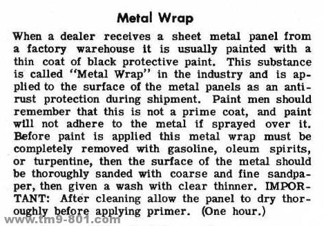

Re: Blurb on frame paint:
Here is another blurb in the 1946&1947 Fisher Body manual:
