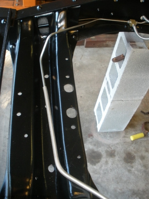

The shittyist part is the front brake line that goes from the passenger side, over the motor mount x-member and to the left front wheel.
This is looking at the T fitting on the right frame rail. The line is in place (a well as the POS can be) and its two inches to long, and has the wrong profile to transition over the x-member.
- rP9040188.jpg (227.37 KiB) Viewed 64710 times
See the first bend just forward of the T -fitting? What the hell is that for? Notice that the line is about 2 inches forward of the motor mount x-member.

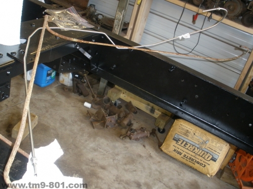

Here's what it looks like from the side.. utter shit.

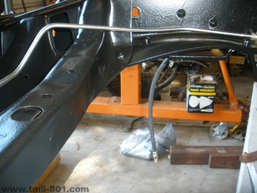

The next issue is from the hydrovac supply T-fitting to the rear axle. Yes, there is a 'shipping bend' that you have to take out. This photo does not show that. The poor fit of the line in this photo is due to incorrect bends and being simply to long.
- rP9040190.jpg (235.81 KiB) Viewed 64710 times

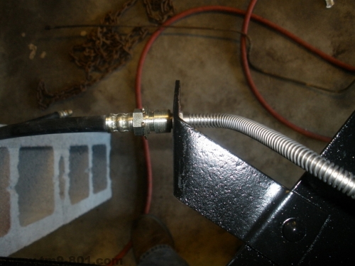

Here is how far the rear line to hose fitting stick out past the line hanger:
- rP9040191.jpg (131.69 KiB) Viewed 64710 times
That's about and inch.

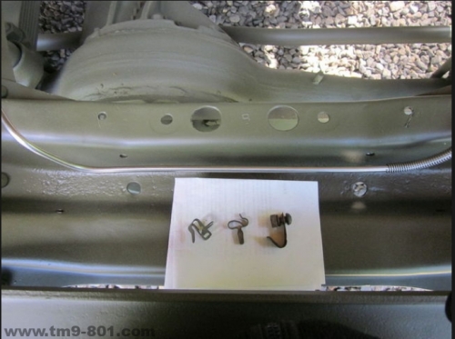

Here's a quick side by side of the brake line clips. The longer ones are G506, the short ones are from Chevys of the 40's... and about 1/2in to short.
- rP9040189.jpg (128.98 KiB) Viewed 64709 times
Re: VoV brake line kit
Posted: Wed Sep 04, 2013 8:11 pm
The one on the left has the logo for Weatherhead. Not made any more, but here's one that looks the part:
http://www.ebay.com/itm/NEW-WILLYS-JEEP ... 1192815391
Just bought a dozen of the myself...

The old ones are cleaning up nicely.. so I am just painting and putting them back on. Some have that logo, others have just a part number.
I have a jeep parts order waiting for next month... will have to add these to it.

pfarber wrote:This is looking at the T fitting on the right frame rail. The line is in place (a well as the POS can be) and its two inches to long, and has the wrong profile to transition over the x-member.
I'm not sure it's as bad as you seem to think. Compare you pic above, with this one from my unmolested frame:
The bend you mention right next to the brass fitting is there, and the cross-over leg really doesn't look that far off either.

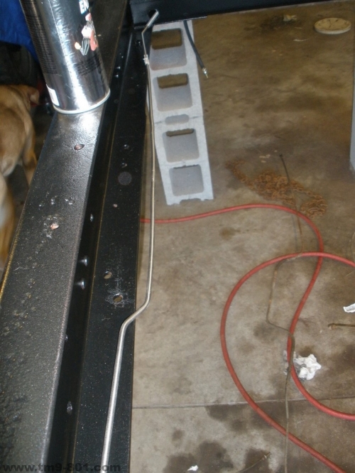

One last WTF. This is the line from the master brake cylinder to the input on the 'vac. This is off an early 42 truck, so it will not have the same 'vac hookup as a later truck.
But still:
- rP9100203.jpg (156.55 KiB) Viewed 64694 times
Can you see how there might be a *small* issue with routing the 'new' line???
