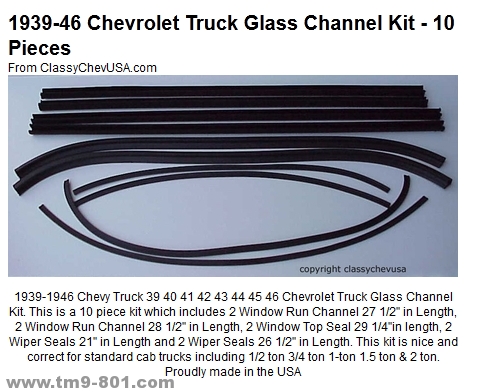

Posted: Sun Sep 29, 2013 9:23 am
This is a rubber kit that would apply to civvy and *probably* early model G506s (no vehicle was safe from the great rubber purge of mid 42).
The wiper seals would go on the inner/out door and acted as both a water barrier and a wind break. This was all redone in felt for the G506.
