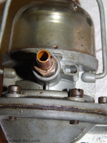

At first glance this looks like a winner, but note the flange just in front of the inlet (that's for a diagonal bale) and the boss where the bale IS attached looks drilled, not a cast hole.

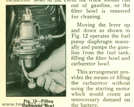

Here is a photo of an early truck, in a photo aptly titled "Filling the Carburetor Bowl".
Filling The Carburetor Bowl
Filling the Carburetor Bowl-100dpi.jpg (143.93 KiB) Viewed 70414 times
I have the same pic at a higher resolution, but couldn't attach it due to the size.

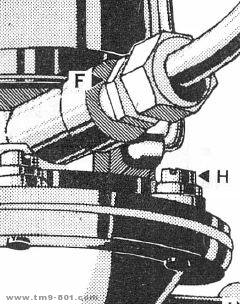

Now looking at the following illustration, we are looking from the FRONT of the engine, meaning the bump shown above, is now hidden by the flange marked 'G'. The other diagonal bump (opposite the one just discussed) would be hidden by the outlet port marked 'F'. You can just see the back, perpendicular flange, right above and to the left of the screw marked 'H'.
Even this illustration, seems to show SOMETHING (see the red arrow) where you say there should be nothing...

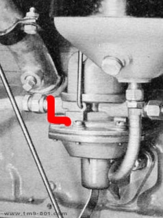

I did find this image in TM9-809 (AFKWX-353) page 14.
The TM is from 43, but its hard to know if the pump is original to the motor as it had a deep sump oil pan. TMs state that the deep sump started at engine #270-266551 and the first references are early 43.. so late 42 early 43??

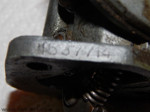

I believe I have a found an original GM-1537714 base. The stamping is light, but it does have the bale boss at 45 degrees.
To cold to stay out in the garage and clean it up/take photos. Tomorrow should be warmer.

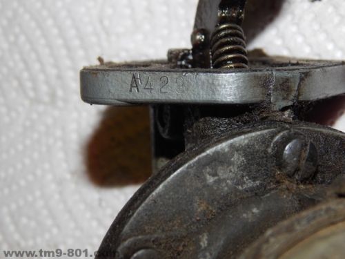

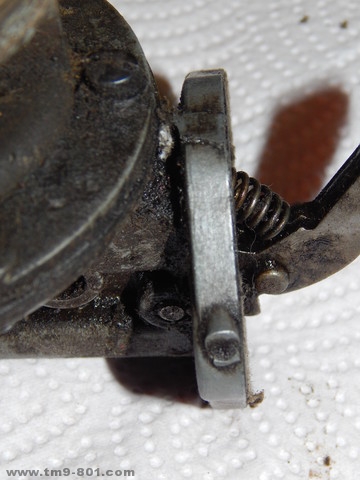

This is labeled as a CCKW fuel pump. Its off my truck.
The part number stamped on the mounting flange
Side
Side
AC cast logo
Bale detail
Looking at this image you would think that the cover is correct. But this image bothers me:
From this angle I should be able to see the 45degree bale in front of the rear bale.

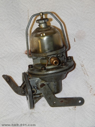

So, I present the one true fuel pump :mrgreen:
Note NO bale at 45 degress, both front OR back:
If I wanted to, I could have taken the top off the marked bottom and put this one on it and have EXACTLY what the SNL shows. But I am not here to 'win' but figure out the PROPER fuel pump.

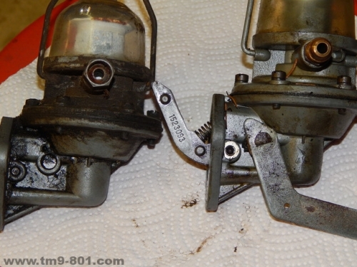

Posted: Tue Nov 05, 2013 9:09 pm

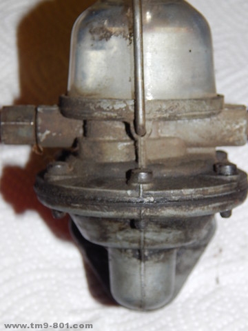

Here are some side by sides (man my Nikon L820 KICKS ASS)
Now just in case you're thinking the extra hole above the primer pin hole on is not on the marked AC pump:
There it is!
One thing I will not about the unmarked pump... the casting is rough. The part lines are not ground/sanded down and there is a sprue gate on the mounting flange:
There is a number... but from what I can tell its not a GM/GMC part number:
It looks like the primer pin hole is sealed with two caps... like I could punch them out... I will take the pump arm out and if there is the tell tale primer pin wear then at some point this fuel pump had a primer arm. Its doubtful, as the rebuild kits DO include an new lever arm.

I did find this:
http://www.vapinc.com/chevy/Fuel%20Pumps/main.html
6 Cylinder Engines Part #
1937-51, 6 cylinder fuel only 429
But why would a civvy pump have the bosses for a primer arm cast???

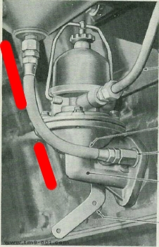

So I'm in my office (aka the crapper) reading over some CCKW TMs (as we all should be) and I see this:
And I think to myself.. god dammit. How could I be wrong about this.
Saddened by my predicament, I flip a few more pages to make sure that what I am seeing is right.
Then I saw it ON THE VERY NEXT PAGE:
WHAT THE FUCK.
How could I have missed this? Well, its easy. The image is reversed. This is what it should look like:
Note the red line parallels the dip stick.
Here is the full page, with the image as it appears on page 327 of TM9-1802A
