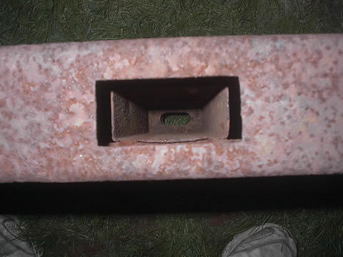

Here's a good shot into the stake pocket.  Notice the drain hole.

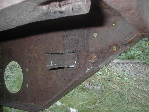

Here's a shot of the floor planks (still OD) and the sills that the side panel bolts to.

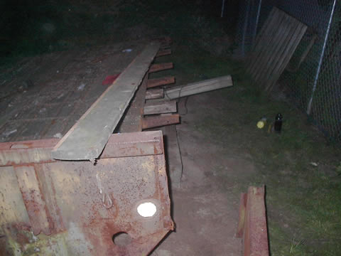

Here's a pic of the floor strips.  Not sure of the originality.... not a lot of info on composite beds.

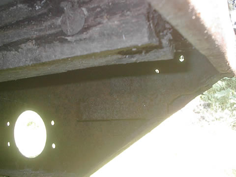

Ground/cut enough off to get the bolts out and free the left side from the rear sill.  The side panel lifts right off.  Just make sure you have all the bolts off the supports.

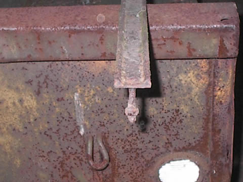

You can barely see the steel tube that was welded on but previous owners.  This weld was right at the bolts and the flange for the side/rear.. so taking it off was a must before anything else came off... beware of hidden dangers... it took me a while to f
