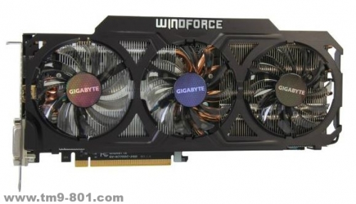

Seems that many believe that the side case fan should push air INTO the case, ONTO the GPU, to help cooling. I'm not sure if that is right either. High end GPUs have 2-3 fans on its one heatsink. Typically the fins are vertical (as seen from the side case fans point of view), as on the Gtx 770 I bought:
So if I blow air DOWN onto the card (well, actually from the SIDE) I will be negating the cooling flow from the 3 on card fans. The Cool Master fans are rated at 95 CFM at max RPM... more than enough to overcome the on card fans.
