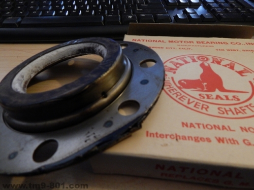

Seals showed up. They are leather but it appears that they are two piece units... a normal seal pressed into a holder and crimped into place. That means that the seals themselves may be replaceable. Will have to look at the originals in the axles to see if that is true.
Here are the seals close up. Note the crimps around the flange.

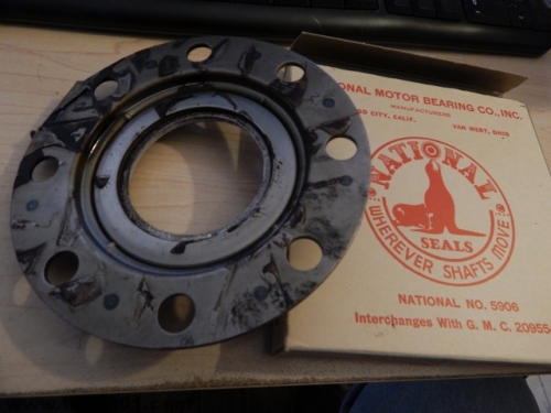

Udder side, just a seal in a holder:
So these will need a good soak in motor oil before installation to get the leather nice and pliable.

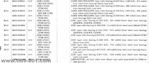

Having a lot more luck finding parts with SKF part numbers. Timken still exists, but using TIM-395 rarely gets a hit, while SKF BR395 comes up instantly.. and for less money.
So for giggles here's an interchange list I made from http://www.showmetheparts.com/skfhd/
TimkenSKFDescription
TIM-395BR395Cone/Roller Inner
TIM-387BR387Cone/Roller Outer
TIM-394A394-ARace Inner
TIM-382BR382Race Outer
