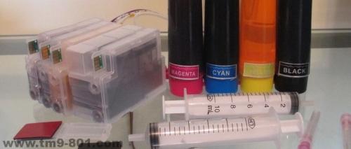

So not wanting to throw $200 at a CIS setup I opt for a local ebay-er that has a $60 CIS and I also order a refill kit for $17.

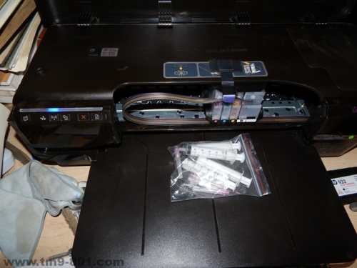

This is just a photo of the extras that you get, 4 syringes with blunt tips for refilling the tanks, two plastic tubing guides.
The kit came with no directions, and the Changlish web site that was supposed to have the most up to date installation tips was a joke.

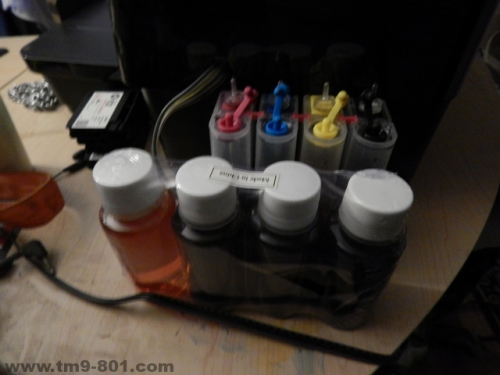

The biggest problem is that the tanks are plumbed wrong.. this is how they come in the box:
Note that the black is on the left and the tubing goes straight 'up' from the carts. There is no HP inkjet on the planet that has the black on the left. NONE. To you would think its a simple task to pull the small plastic elbows out of the tanks and reposition them. Yeah.. but ink squirts all over. Now your black tank is on the right, but the tubing is laying in such a manner that it will never work flat as in my photos. So you try and twist the small plastic elbows and they become destroyed. I had to contact the seller and got them to send me (FOR FREE, including shipping) 5 new elbows... of course they said they 'never had this problem' and 'sold thousands of kits' (ebay said they sold 10 kits) yet no HP inkjet has the black in the left... so there's that.

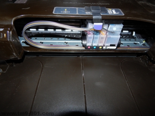

Here's the CIS installed:
Note the clear carts are exact dupes of HP carts. The tubing runs under the print carriage (the heads are about 2 inches back) and I simply glued it to the metal rail... its all trail and error. Note that the tubing runs to the left, is flat, and each cart has a custom fit to the elbow. This is the work you must do. Also, one VERY IMPORTANT thing that was never mentioned in the joke directions.. you *MUST* prime the tanks. That means get the air out. If you look at the sellers ebay photo you can see that the tubes are not full of ink. Air pockets are bad, um kay? There are several videos on youtube on how to prime the CIS, its easy enough, but never mentioned in the directions... I just knew it had to be done because when I researched buying one every other CIS seller mentioned it.
This is the side of the printer and the tanks/refills. I did drill a half inch hole so the tubing would run flat under the carriage (even when parked).

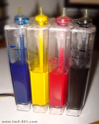

Here's an image (not mine, but I have the same issue)
Note the Yellow tank, see the ink flowing UP the tube? And the filters at the top... they are ink stained because ink has pushed up into them and clogged the pores in the filter. The filters at the top should be clear/white. Mine had some ink in them and I cleaned them by soaking them in water and blowing through them to ensure the filter was passing air.
So after I cleaned the filters, a few days later, still the same issue.. black is good, colors seem to 'run out of ink'. So I took off the filters and the stoppers leaving the ink tanks open to air. And it really helped. Banding stopped, test prints were good and the colors solid. That lasted a few days... so to google-fu and my last, hail mary attempt.

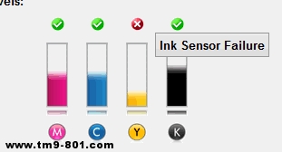

Well it looks like the printer may have had an issue out of the box. I installed the isobaric chamber (aka check valve) and noticed that intermittently the paper would not advance under the sensor, cause a fault, and eject it. I figured it was just dust or something. But now this:
This is even with factory carts in.
So I go to HP and make sure the printer is under warranty. HP says is not. :roll: :roll: So I had to email support with proof of purchase (my newegg invoice) that I bought the printer in Dec 2013. Since its a one year warranty they should accept it back for repair. I purposefully kept the box just in case.... good thing I did. The box also has the shipping label AND the proof of purchase sticker.
So with any luck HP won't fight me on this and service the printer.
Its always something.
Re: HP 7110 and CIS system
Well after 1:04:57 with HP support I'm getting another printer. Evidently this is a known issue (ink sensor failure) because, well, they said it was a known issue for this printer.
