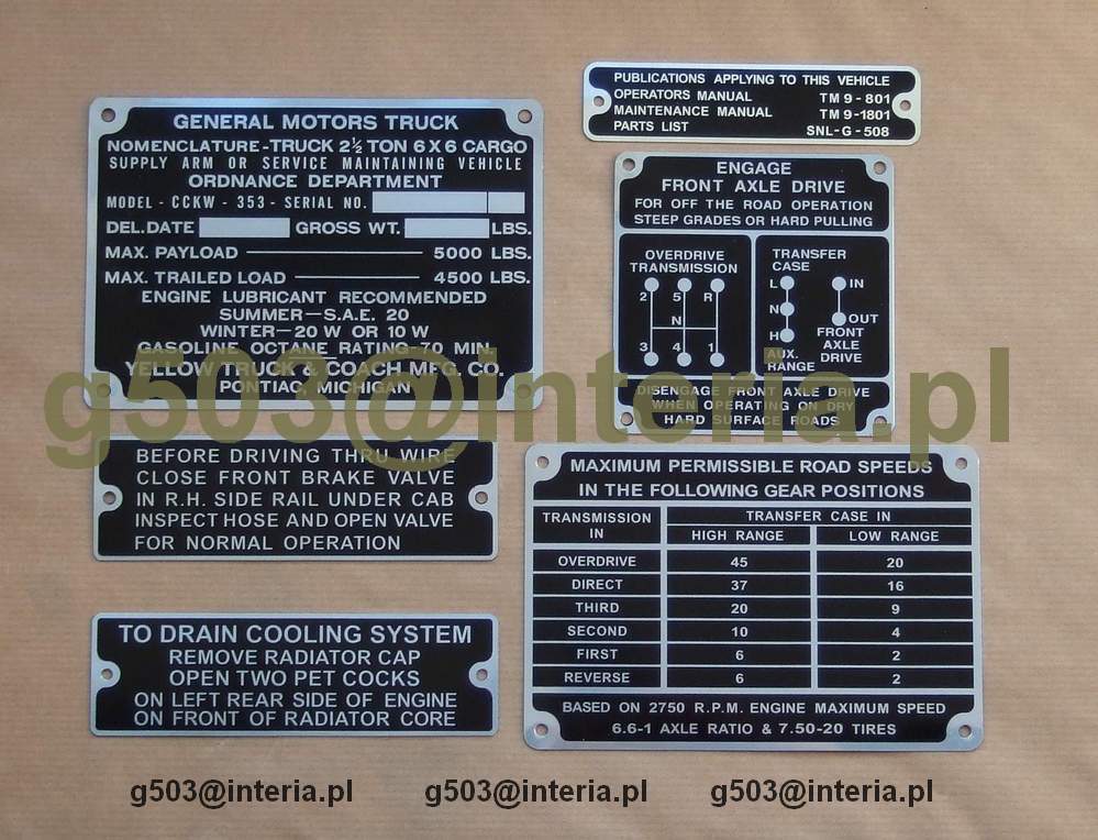

There is a guy in Poland selling CCKW data plates. Great. We need quality vendors. BUT the data plates for the CCKW OPEN CAB W/O wench (ie my truck) show 20wt oil for summer use. Nothing I have ever seen shows 20wt oil as the correct summer weight. 20wt oil craps out at 60F... not very summer like.
Heres a copy of the plates....

As I pretty much knew these data plates are screwed up.
All the other plates are good, but the oil weight is just plain wrong.

Here is a more definitive answer from http://www.g503.com/forums/viewtopic.ph ... 802#711802
TM 10-1563 2½ ton 6x6 models CCKW 352 &353 published august 17, 1942:
Serial and operating data plate reads:
Summer -S.A.E. 20
Winter -20W or 10W
TM 10-1269 2½ ton 6x6 models CCKW 352 &353 published january 19, 1942
Summer -S.A.E. 20
Winter -20W or 10W
This plate offered on ebay belongs to a EARLY closed cab truck, so no 1943 open cab blah blah blah!
Only thing wrong with the set of plates offered is that they are not a matching set. Publications and warning for driving thru wires must be left away for closed cabs. For open cabs the operating data plate is to early!
