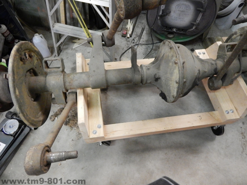

Here's the trolley with a split axle:

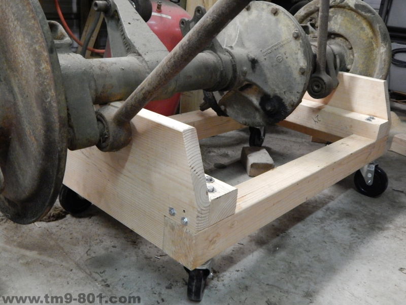

Top view:
Its a very simple design, 4x4x6s mainly and a 10x12x2 with some casters from Harbor freight. Total cost is about $70 to make. The casters are 330lbs each so they will handle well over 1/2ton (HF item #69852).

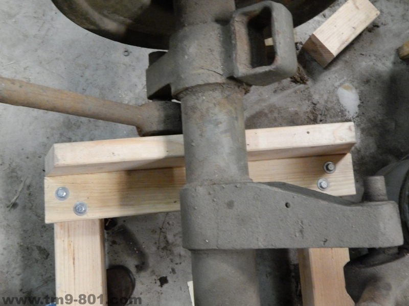

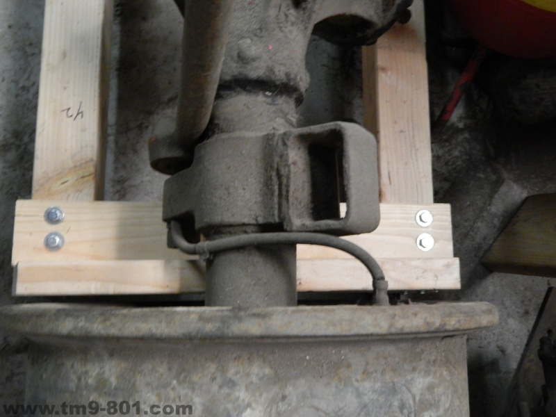

The length is 42 inches and that allows the supports (10x12) to fit next to the spring seats:

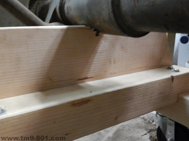

The support is notched otherwise the axle will roll off:
