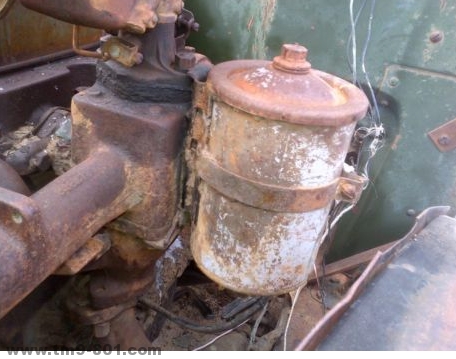

I found this on e-bay:
Its not the same as the early mount, which from the article I cited, states that it mounts to the horn mount and heat riser.
I have not found any pics of the early Y model engines with a filter. Would be interesting to see an original.
