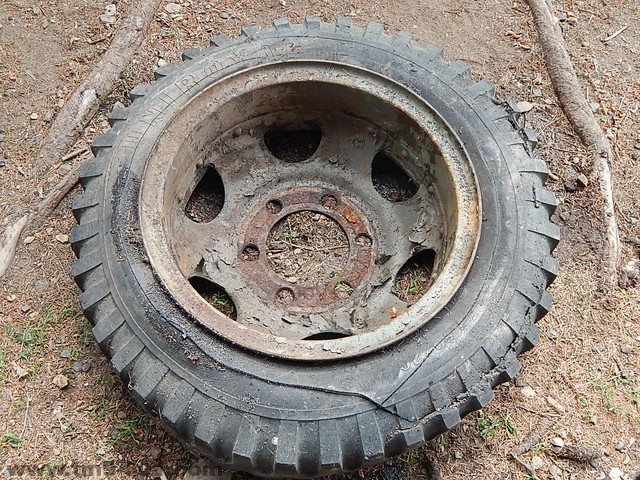

Your typical to-far-gone rim and busted tire. Without being able to break the bead the lock ring ain't coming off. I've tried to torch the rim.. but its really to much work compared to this new way I have.

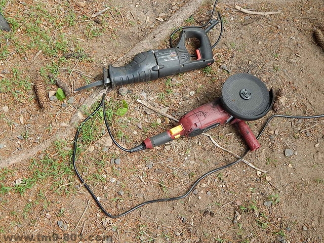

Tools: A Harbor Freight 7 in angle grinder and a saws-all. The grinder need the metal cutting discs to cut the steel wires in the tire bead. The sawsall has a standard wood/steel 6-8tpi blade to cut the tire/cord. You can get the grinder on sale for about $30 and a 5 pack of discs for about $12. The 4 1/2 in grinder disc will not fit in the recess of the tire to cut the bead as the disc wears. I have done 3 tires on a single 7in disc and its still got lots of life left.

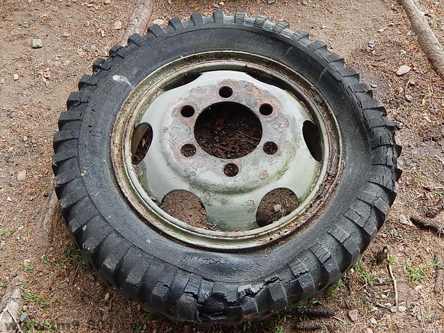

Cut around the tire on the sidewall about 1 inch above the rim lip. You need to be pretty close to the rim so the grinder disc can get to the bead. Do this to both sides and then cut accross the top of the tire so the entire carcass opens up and the rim falls out.

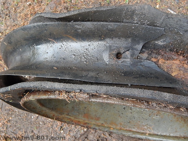

To cut the liner, use the inner tube stem hole and saws all the liner off. Liners are cheap... plus they will be all ratty and rust damage on the bottom.

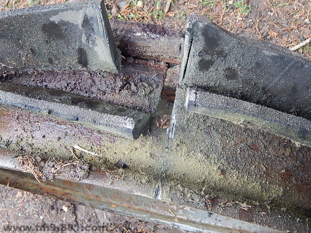

Use the grinder to plunge cut into the bead wires. I just lay the wheel onto the tire and let the weight of the grinder push it. If you try to hard the tire will grip and either buck the grinder or damage the disc... it will smoke a bit, but not much.

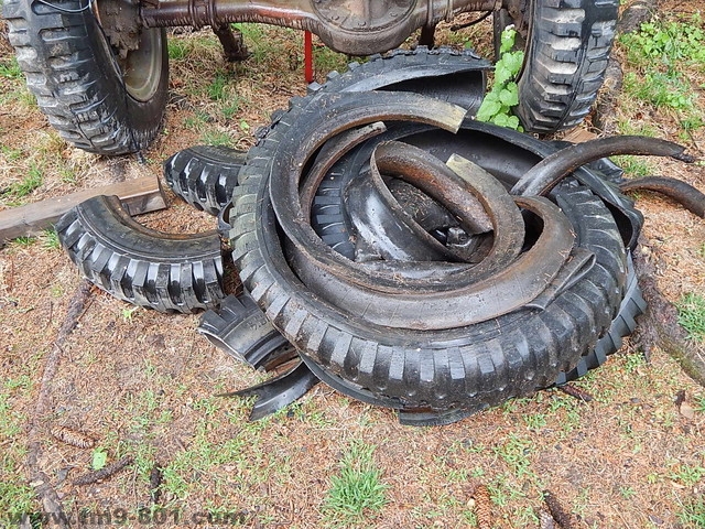

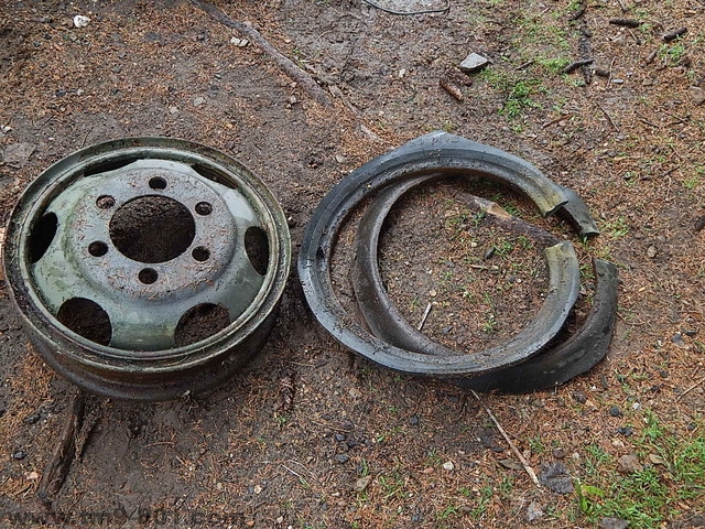

All that's left is to peel away the bead:
And marvel at all the precious war material that you are about to throw in the garbage:

I've gotten pretty good and cutting the wires with the grinder... if you go in almost parallel to the rim flange (or whatever the wide flat part is called) and then just ease the grinder into it they cut nice.
