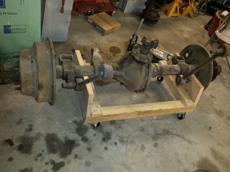

Just some photos of my second dolly:

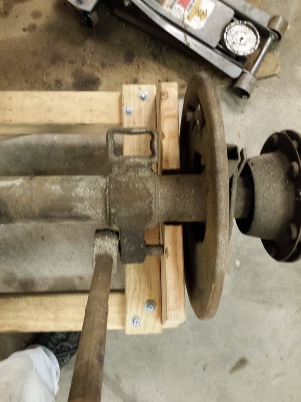

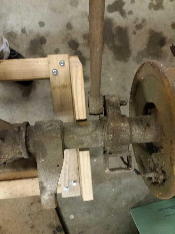

The only critical dimension is that you get between the torsion bar mount and the brake backing plate
These would be the same on the split and banjo axles.. so its really the only 'static' point... everything else moves around.
