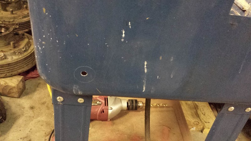

Spot the hole for my nibbler.

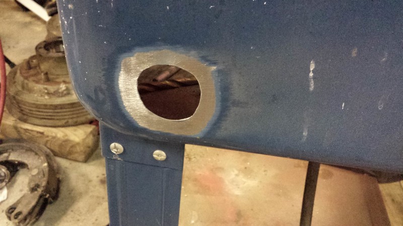

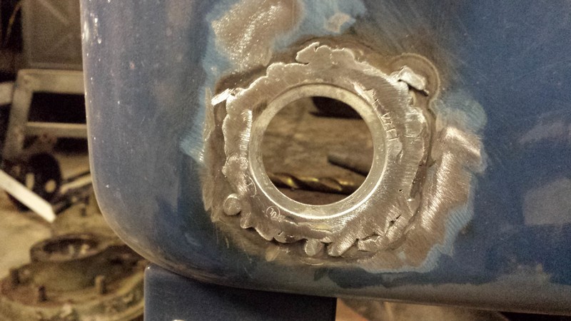

Traced the Reducer leaving enough lip to weld it to the tank. Cut tub and sand off the paint.

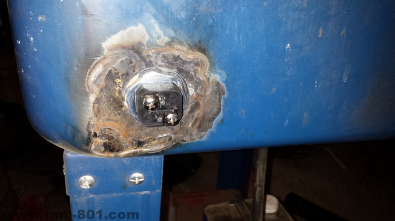

Reducer in place and first round to tack welds (MiG) ground down.

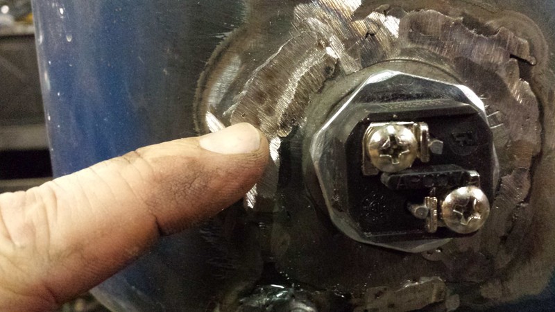

Test fitting element (4500Watt @ 240VAC) Note the pinhole that is leaking water. The reduce was thinner than the tub steel so getting good penetrating welds without burn through was tricky.

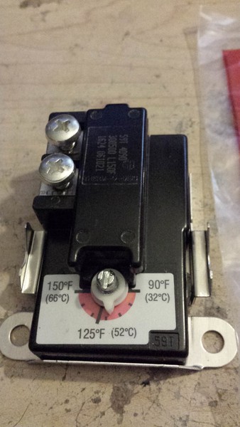

I will put in a t-stat (the lower t-stat on a water heater is for a a single element) so the system is a set it and forget it temp wise. I could have just unplugged the element when the tank was hot enough but if you forget then you could have super hot magma and I don't want to get burned.

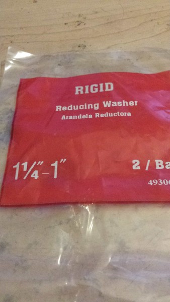

Here are the bags for the reduce and the lock nuts.
The element was $11, the t-stat $8 the reducer $2 and the lock nut $2. The RTV will be about $8. So about $30 so far and I already have a metal box, switch, cover and cable for power. So if you had to buy those items that's probably about another $6-8.

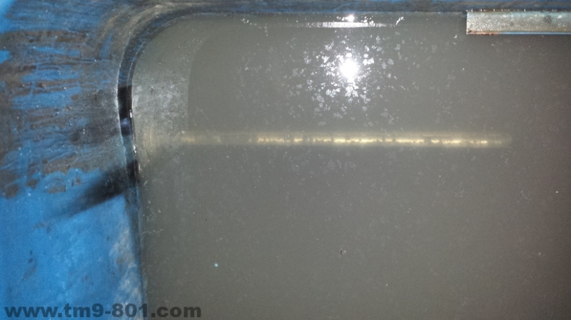

Got the sealer and installed the element. Filled the tank with water and let it sit a few days to check for leaks:
Now to try and get a cover or over the element.. maybe a piece of black iron or some steel mesh epoxied to the bottom/side.
I really should have made a removable heater. The element is very large and with a cover I'm going to lose about 20% of the usable volume of the tank. Depending on how long this lasts... if I do have to repair it I'm just going to weld up the hole and make a drop in heater. For now this should be OK.
