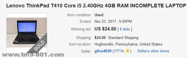

Well the first of two Lenovo laptops arrived. $50 delivered for an I5 4Gb laptop. I had to add an HDD (I seem to have quite the collection of spare parts... no, I'm not a hoarder, honest) and buy an HDD tray ($2) to make it look pretty. I reused a copy of Win 7 that was then upgraded for free to Win10. Win10 kicks ass.
There are dozens of these laptops available on ebay. One caveat to this specific laptop is that the 'lowjack' BIOS was enabled. It doesn't effect operation, and one call to the company should get the laptop out of the 'lowjack' system. Just a caution, READ THE AUCTION DESCRIPTION.

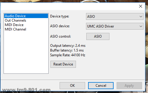

Here's my current laptop / drum module setting and how it's running. Remember this is a $25 laptop I'm using.
I am not using the free ASIO4ALL driver, but the Behringer one. Not sure if there is a huge difference as both are sub 3ms

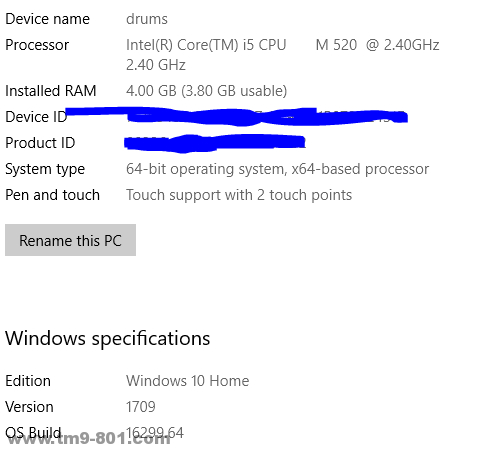

My $25 laptop specs. 4Gb Ram and even with EZD2 running I don't use more than 2Gb total.

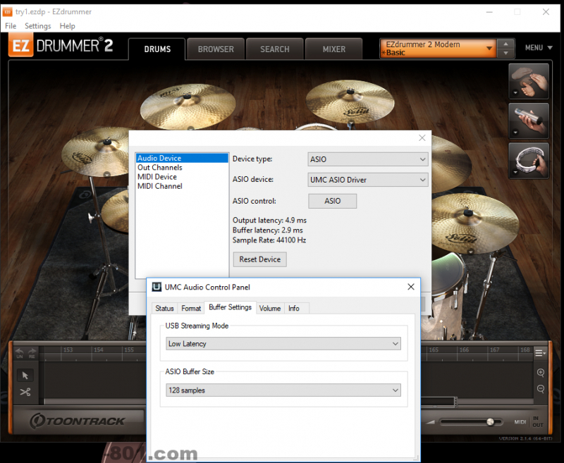

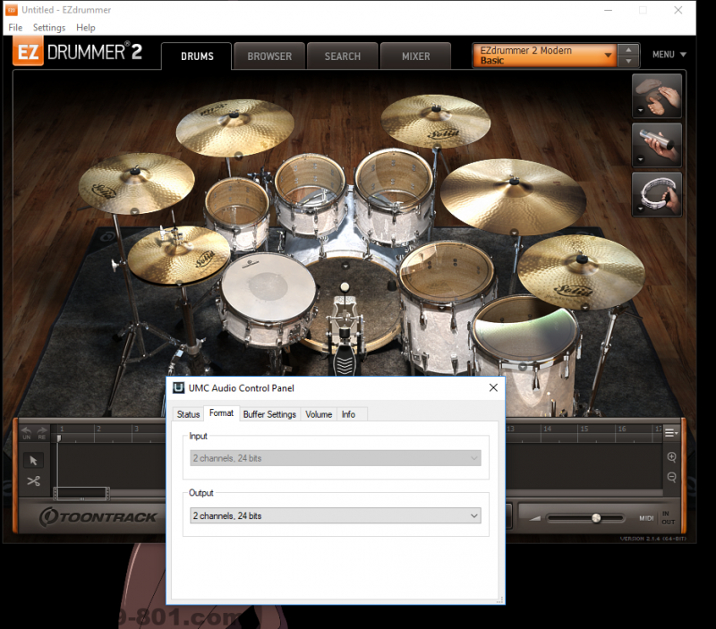

Today was an interesting day. Was noticing a ton of static/pops when playing drums through EZD2 and the UMC202HD. To rule out the drum module I ran straight to the amp and it sounded fine (although dead because stock drum modules suck). So I figure its either the laptop or audio interface. Various setup changes got me no where. I also changed the ASIO driver to the Behringer one and even windows sound... still static.
So I set everything up back to my 'stock' config and start to google. I hit on a random DAW post about INCREASING buffers to smooth out pops. So I increased the UMC202HD buffer from 64 to 128 and it the pops/static went away!!! I did get a little increase in latency (2-4ms) but still all in all not noticeable at all... and more importantly EZD2 was sounding great again.
Here's my current, static and pop free config:
