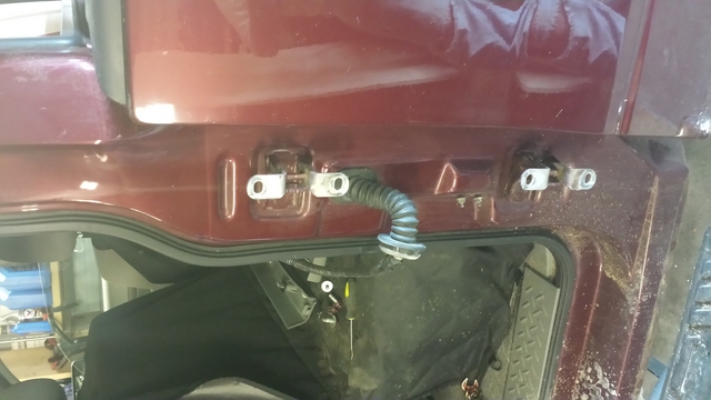

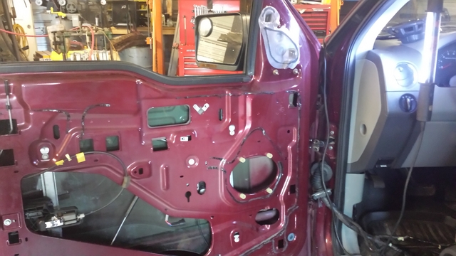

Door with all panels and harnesses out:

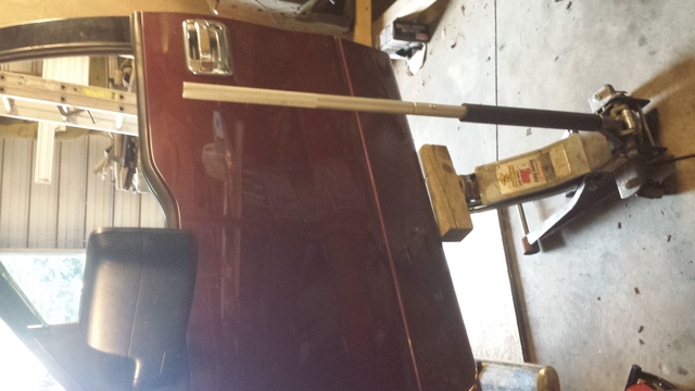

I heard the door was supposed to be heavy... so I rigged up a support. Door was about 50lbs.. not to bad.
Rear door off.

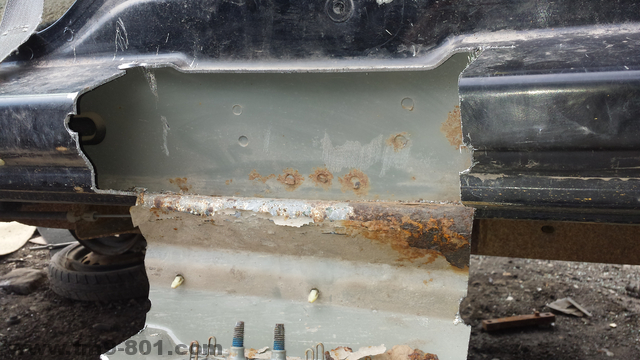

Went to the junk yard to get a bracket that supported the inner rocker panel. The old one's flanges rusted off and the metal is to rusted to do a quick 'weld an L bracket to and call it done'. The bracket is part of the cab floor support and actually crosses under the entire cap as one big transverse stamping. So I needed to cut it off the donor truck. The rockers on the donor truck were in great condition.. I felt kinda bad doing this to it:
You can see the spot welds I needed to cut to get the bracket off. Once drilled I sawz-alled the other side and BAM done in like 30 minutes.

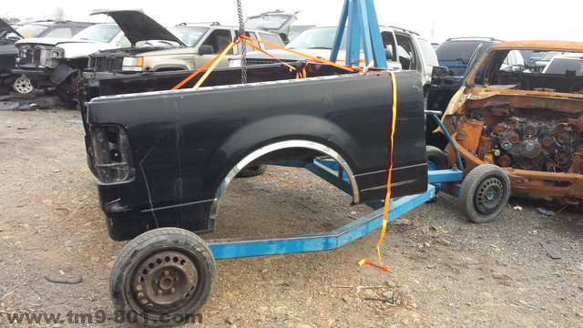

I'm eyeing up the bed on this truck.. it looks close to what I need but it would need a total repaint. I only have about $250 in sheet metal bought and the truck bed would only be $150 from the yard I'm seriously considering buying it. Its in MUCH better shape than mine but I am only 60% sure it will look right. The early 2004 F150s had a weird 'Heritage model' that was really a 2003 labeled a 2004. Since the build date on this donor truck is 12/03 that makes is 2004 model year but also a possible 'Heritage' model. The bed does look different on the inside, but I really only care about the body lines. Tomorrow will be a nice day so I'll take another look at it and then also see what other parts I need to cut off for the rockers.
Re: Ford F150 rocker panels and wheel arch repair
Used the junk yards engine hoist (free if you have it less than an hour) to carry the bed to my trailer.

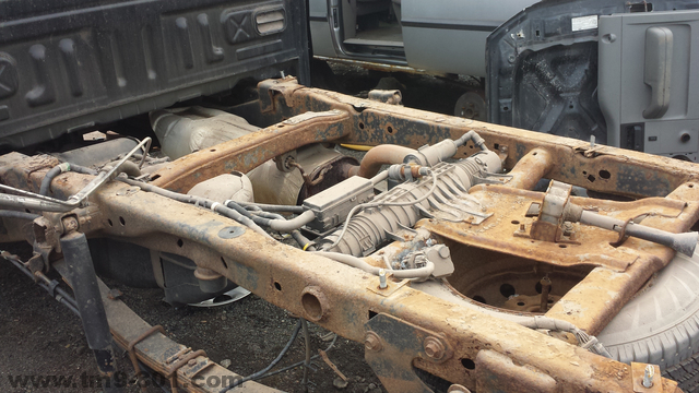

Finally got my lard butt out to the garage and did more work.
And after the fuel tank is off

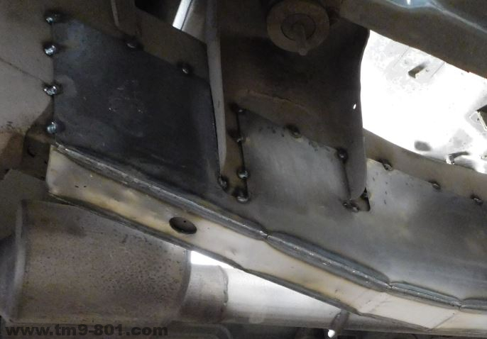

The website for the F150 frame section repair is: https://www.autorust.com/
From my video I was trying to remember if they notched out the cab mount.. they did. So will I. Yay for saving some work.
If you look at the web site you'll see typical 2004-2008 F150 frame rust at the sloped part.
