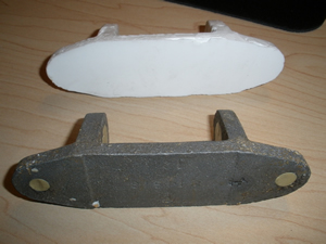

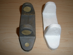

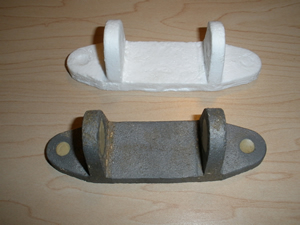

First part has been mastered. The lower hinge. Pics are below.
The tan stuff in the original casting is putty because the mold will not release if the casting material in in them.

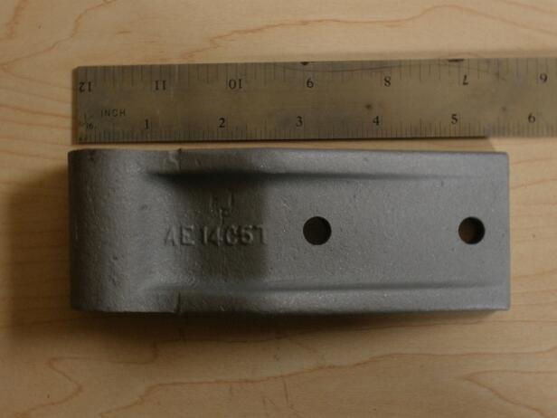

I finally have one! The uber ridiculously hard to find tailgate hinge. Yo do not want to know what I had to swap for it, but it was worth it!
I he did not have the pin, but this is good enough! I am making patterns and expect to get cast parts back in a few months.
They will NOT be cast steel. Right now it looks like aluminum with steel inserts is the best that can be made. No foundry is willing to do only 30 parts. If you know of one, please PM me.
