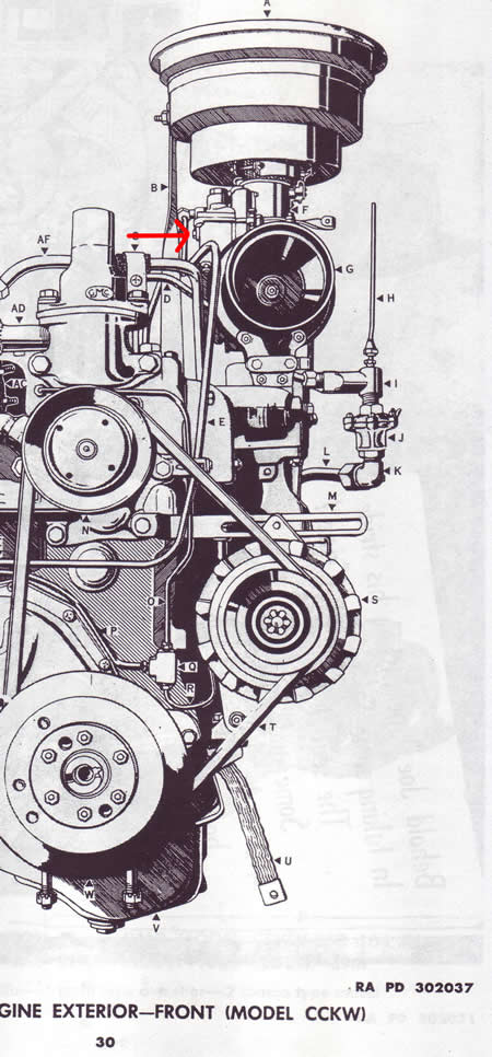

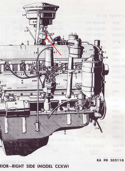

More images of the fuel bowl plug. These are from the JULY 1945 version of the SNL. This is one month before the war ended and all CCKW production was canceled.
In the engine ID section we have the plug clearly visible. If its not that important a part, why take the time to draw it?
Here it is again. This is 1940s tech. These drawings were hand drawn, they simply didn't click the 'rotate 90 degrees' button on their CAD computer and get new view.... it was hand drawn in.
This drawing is EXTREMELY interesting because it does not deal with the carb AT ALL. Its an exploded engine diagram.. yet they STILL drawn in a sight plug.
So the next time someone tries to explain that the CCKW carbs didn't have sight plugs on them ask them what proof do THEY HAVE? I bet you get excuses, conjecture, stories about their military training.. everything but PROOF.

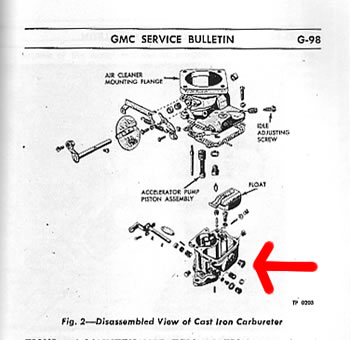

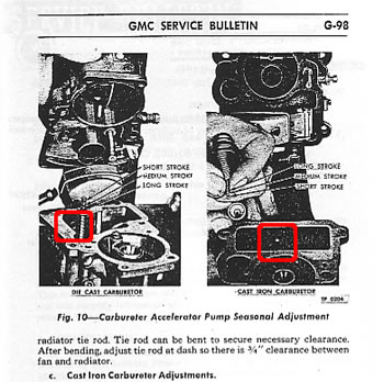

I'll probably consolidate these posts into a single thread, but yet ANOTHER bit of historical evidence for the CCKW fuel bowl sight plugs has been found.
Please see GM Technical bulletin G-98 regarding the 'new' cast iron carbs.
From the SB Cast iron carbs started production in Feb 1944 (no date or SN given) and the service bulletin CLEARLY shows the fuel level sight plug in Figure 1 and Figure 2 (plate numbers TP0202 and 0203). The July 45 SNL gives a SN start number of 321078 .
So, it seems the time line for the sight plugs is complete.
From start of production to approx Feb/Mar 1943 there was a standard GM-2135998 WITHOUT the fuel bowl sight glass. (TM10-1563 Jan 15, 1943)
From Feb/Mar 1943 through Feb 1944 the carb was GM-2135998 WITH the fuel bowl sight plug. (TM9-801 April 1943)
From Feb 1944 end of production the cast iron carb GM-2137474 WITH fuel bowl sight plug.
So when some nut job says they have ORIGINAL NOS CCKW production carbs remember than after Feb 1944 the die cast was phased out. The die cast was only used for the first 2 years of production.

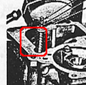

Well it seems that the 'elusive' fuel level sight plug has finally been spotted in an official GM publication! I missed it at first but while on the crapper reading the SBs again I noticed the 'Mona Lisa' of fuel plug portraits! Side by side die cast and cast iron picture that showed the fuel bowl AND the plugs!
Here we go.. smile for the camera!
Hers a blown up shot of the die cast plug:
Now to correct any possible questions:
NO they are not the fuel inlets, both carbs have the fuel inlet on the TOP COVER so the float needle can regulate flow.
YES that is the fuel bowl. The cover is above it and has the floats attached to it.
So I think my quest is finally over. I have at least 5 official documents for at least 2 different sources that are dated and include part numbers.
