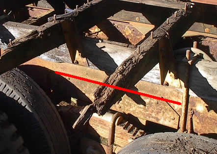

Recently a question was asked on the mounting of a CCKW bed. All the 'know it alls' (as we will see, don't) said that the bed sill was drilled so the rivet heads of the crossmember would fit into them and allow the sill to lay flush on the frame. BULLOCKS! I said. I have in my possession 2 beds and one was drilled, the other had a section cut out, tapered on both ends... so I dutifully posted a picture of it.
Well, here's further proof that the know it all's, well, don't.
Note the TWO cut outs for rivet heads. I know this is a pretty banged up chassis. But the bed appears to be a composite one and they were used from 44 on. Add that to my wood bed and it seems a pattern is forming.
Which one is 'right'? Well, since the wood beds were not Yellow Coach/GMC Truck produced one could assume that each wood bed supplier had their own method. The beds are not in the SNL-G-508 other than as a reference PN and no specific TM for them was produced.
I'll be looking for more examples. But right now both were used, on at least two separate bed type.s

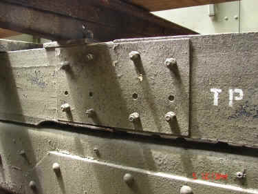

JACKPOT!!!!
Lookie here. A late production CCKW 353 with the cut out for the rivets on the bed sill.
Lets blow that sucker up and look closer shall we???
Well well well... looks like a taper in the sill to allow for the cross member rivets above the rear bogey. MY MY MY.
Let me sum this up with a 'SUCK IT' to all the people who say that the beds are counter sunk to allow for the rivets only.
All you gotta do is LOOK and not blindly follow.

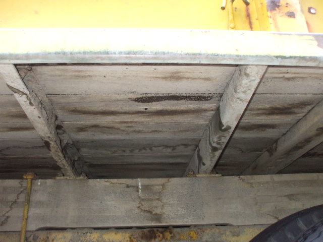

And here's a close up of a wooden bed off a 4/43 CCKW
So who believes that all CCKW sills were bored for rivet heads? I got 3 perfect examples that clearly show there were other methods.

Just another pic of the 'notch' or 'cutout' type bed sill mounting.
More pics are available at http://www.northwestmilitaryvehicles.com/CCKW.html
Another interesting pic of the same bed sill. First, the sill is laminated (you can make out the individual lamination's AND you can clearly see the front 'notch' or 'cutout' for frame cross member rivets.

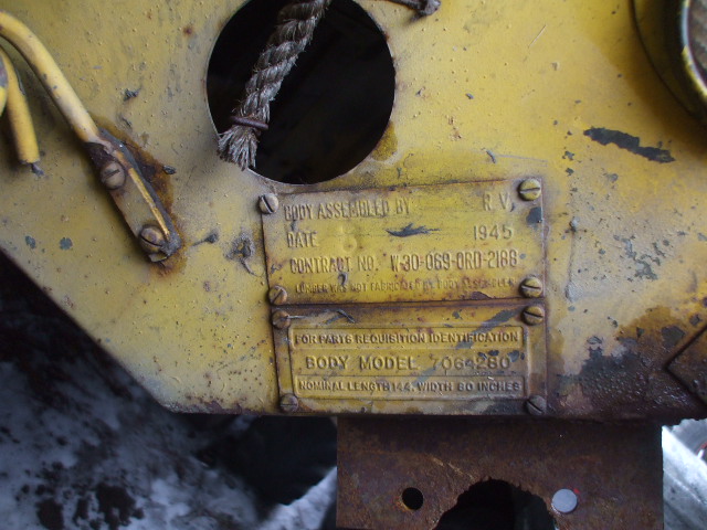

Also, it would seem that we have a data plate for a composite bed with notch type cutouts:
Case closed?

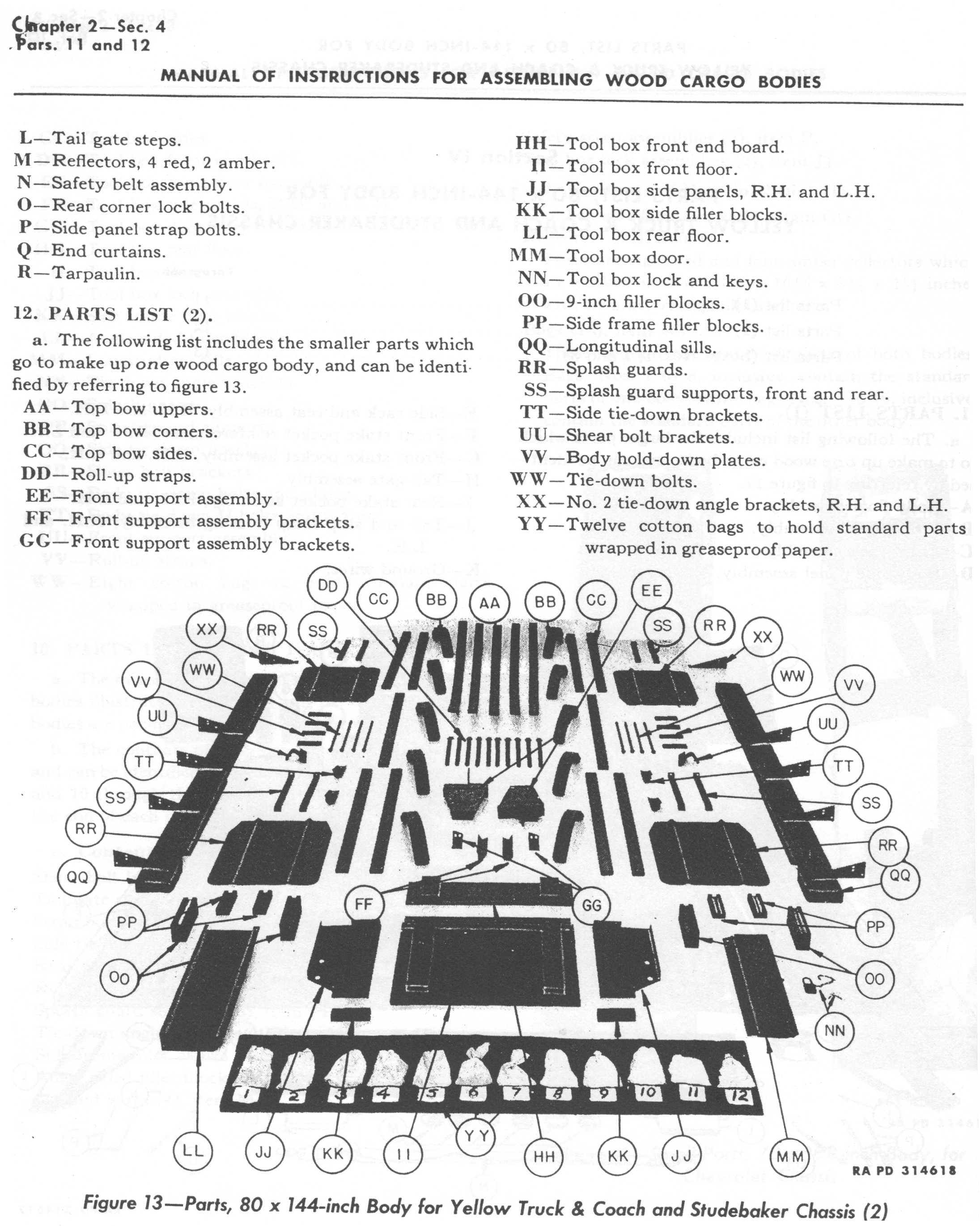

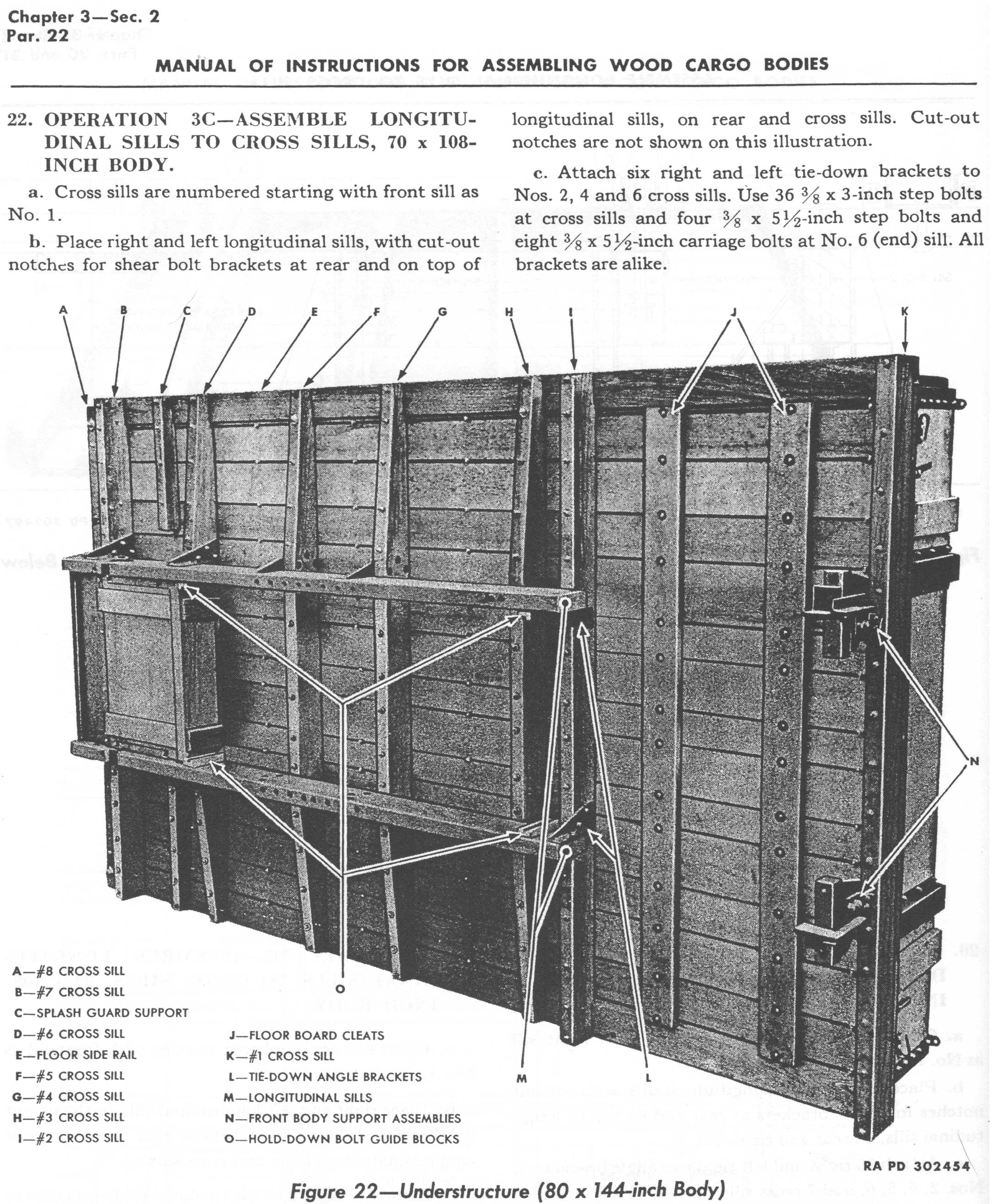

Here is one of the pages of the 'Manual of Instructions for Assembling Wood Cargo Bodies for Export'. Its dated 8/43 (the composite bodies were right around the corner) and it shows SOME of the work required to get a standardized wood body to fit a Ford
Now the most interesting photo is next. It clearly shows the sills and that they are NOTCHED and both sills are the same length.
The sills extend all the way to the second crossmember (the only other crossmember is the front headboard or sill #1).
But even though the layout of all the parts for the 80x144 bed shows the notch, all subsequent pictures show the drilled holes:
So as far as I can conclusively tell, yes, there were two types of sills. And you explination of the different rivethead pattern is as good as any. Maybe if someone had pics of the rear wheel mounts and the rivet heads? The manual does not say anything about the sills.
The manual clearly states that they are also for Studebaker trucks and that sills are the same length.
